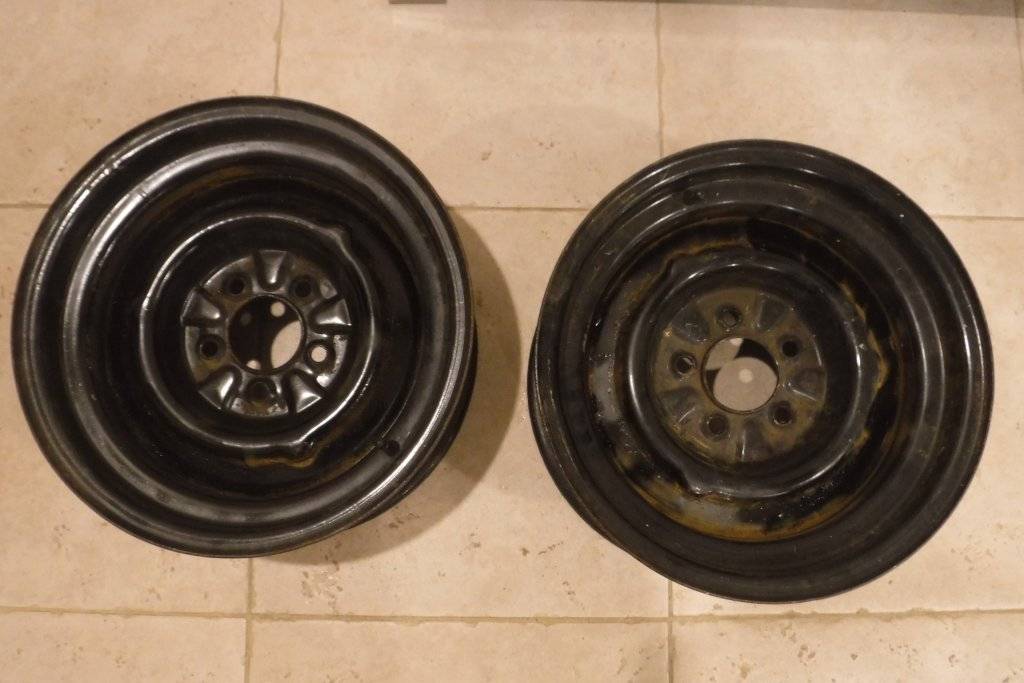

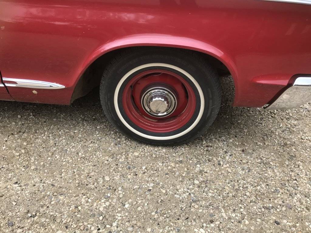

Best of my knowledge the big caps ended in 1965, at least for cars. My 67 disc wheels took the smaller caps, see pic. You can buy new or used 15" wheels that take the small caps & modify them with screws so that the large caps will fit, that's what I did. Of course you'd want to verify fitment with whatever disc setup you're using.

Believe the large caps were used only on the 14" wheels, both 13 & 15 inch used the small caps. The exception might be trucks. Most just go with the newer style caps when converting to 15". I used 3 pan head screws on each wheel to secure the older caps.

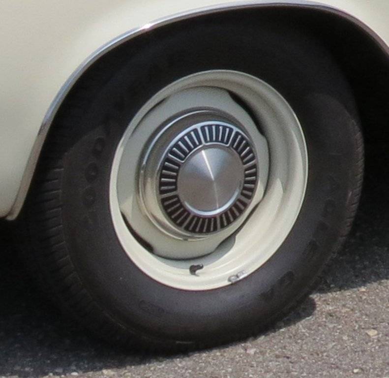

My wheels are later 15", from 67 and 73. I have the standard 1966 Chrysler caps on them.
