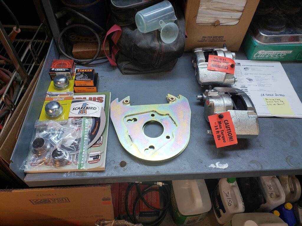

The scare bird kit I got for the 64 880 uses all pretty common parts. I went with their larger calipers, but it uses GM pads and mid 70s Volare piston and rebuild parts. The rotors are 77 Cordoba. I might buy a set of rotors just to have in case those might go away, everything else should be around for a long time.
