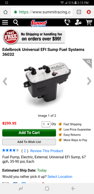

Try this with a fitech efi. Its what ill be doing on my next efi swap so i dont have to do a return line
If you're using the RobMC surge tank, don't you do that so you don't need the return line?
