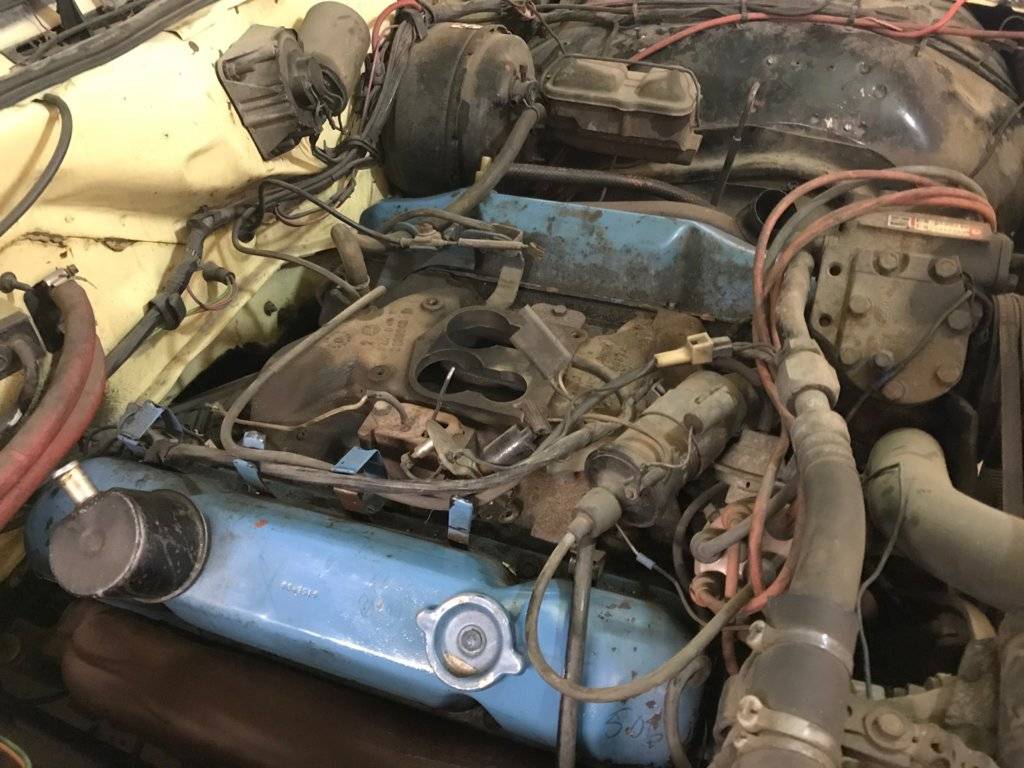

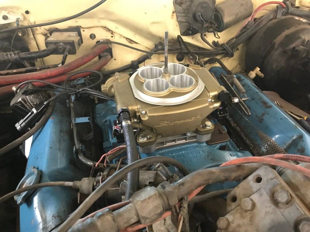

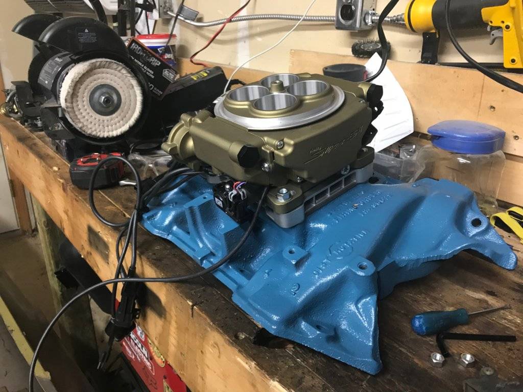

Our family pet c-body Chrysler "Thelma" (named after Thelma Houston) was the recipient of a Holley Sniper EFI setup on top her 400ci engine last summer. I had been fighting with the Thermoquad (and even a rebuilt Thermoquad) for too many years - I'd had enough. Of course the upgrade led me to replace the starter, blast and paint the manifold and replace the rocker cover and pan seals. It was a fun little project and I recommend it. That omnipresent kick-down choke and cough are gone and now I don't fear pulling out into traffic and feathering the accelerator from a light or muggy days are no longer anxieties. Life for Thelma is better and I driver her more. She's sleeping for the winter but in the season my wife even takes her to work and the kids enjoy rides in her. The EFI install saved our relationship.

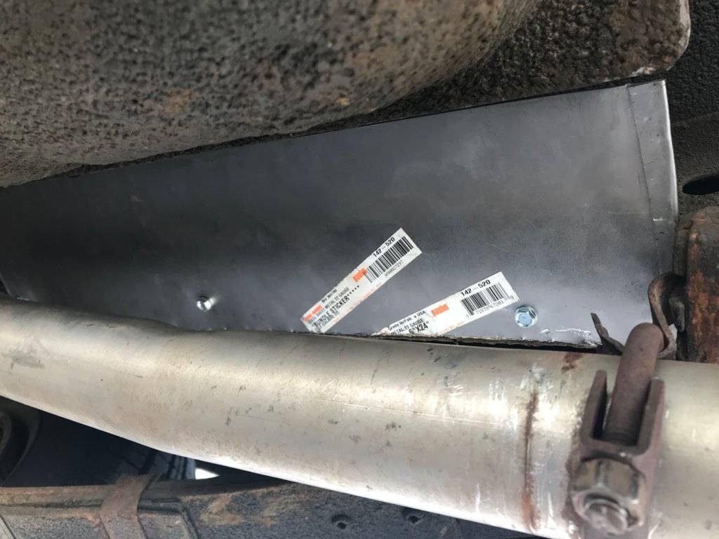

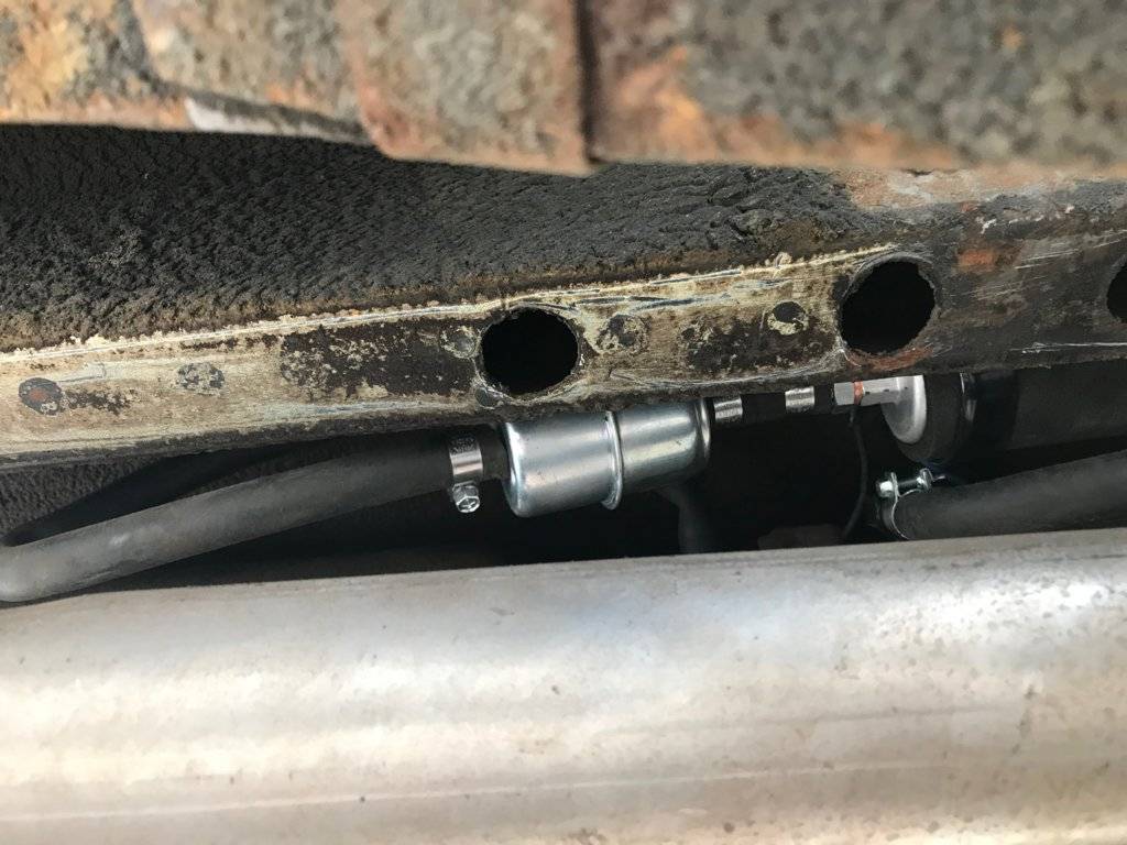

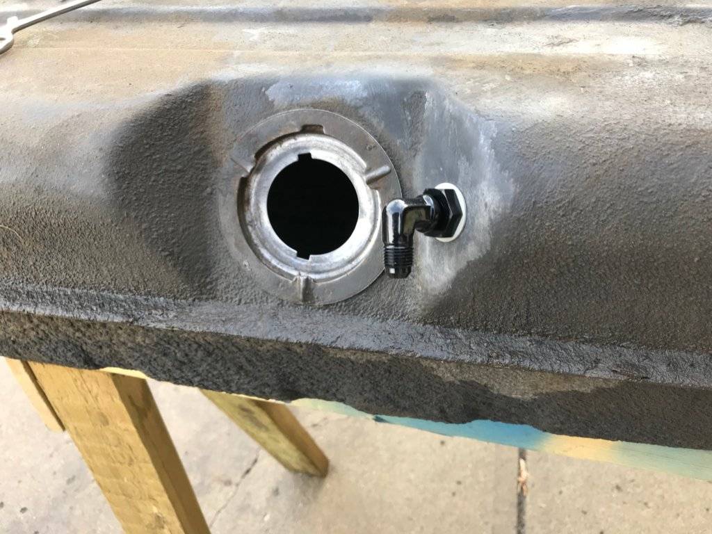

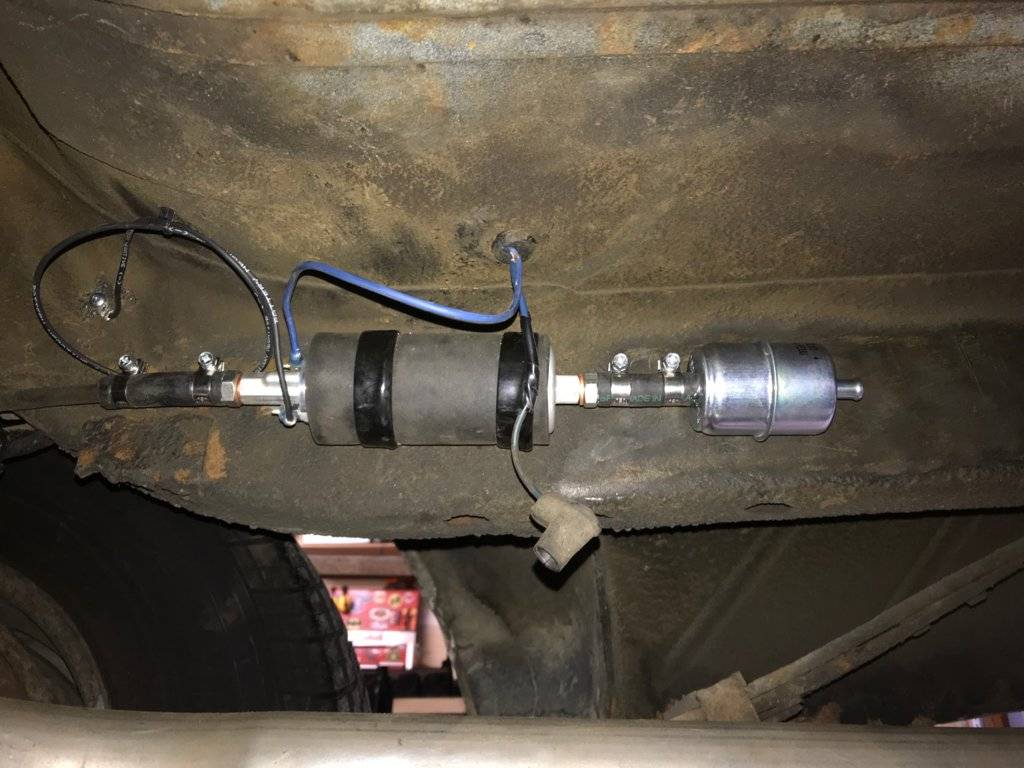

My fuel pump and high pressure filter live up next to the tank and the return line was a bit of a fight but not the end of the world. The exhaust pipe is about six inches below the pump so I put a piece of tin in between to block heat and keep water off.
I just emptied the tank, filled it water then drilled the hole for the return while the hole was under the waterline, then drain. I welded a bung for the O2 sensor in the exhaust too. The kit includes a weld-free collar if welding isn't an option. Tune-wise I set a tune through the wired interface (i keep it in the glovebox) and forget it. It learns as it goes and is getting better and better (please don't ask me to define better). I want to handle the ignition side this year with distributer and coil that are modular with the EFI (money dependent). It's only been one season but the whole system has been pretty set-and-forget so far - but I've heard nightmares in the holley forums too. If I did I major trip I'd probably throw a spare pump in the trunk but for around town I'm pretty confident.
