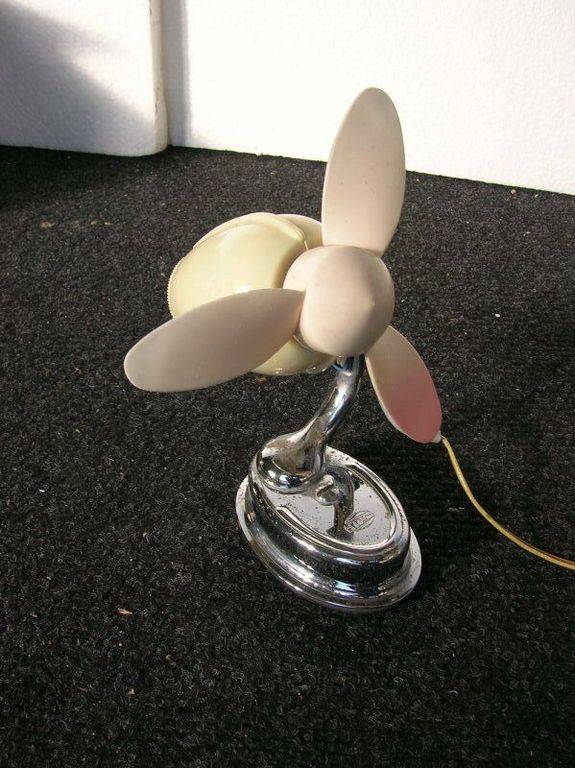

    Another option, and this was something that was a common accessory when these cars were new (at least around here for winter) is an accessory fan mounted on the rear deck. Something "vintage" could be kinda cool if done right.
  16. swisherred
    swisherred Well-Known Member
    Messages:
    900
    Likes Received:
    447
    Joined:
    Jan 19, 2016
    Location:
    winston salem, nc

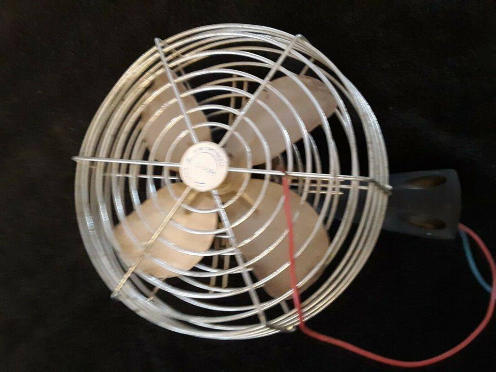

  19. Big_John
    Big_John Illegitimi non carborundum FCBO Gold Member
    Messages:
    11,917
    Likes Received:
    6946
    Joined:
    May 21, 2013
    Location:
    Marcellus, NY
