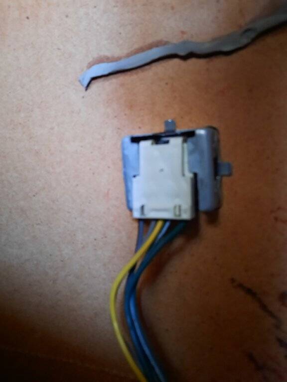

Oct 9, 2020 #1 JPMODL Active Member Joined Nov 3, 2016 Messages 425 Reaction score 1,085 Location WI Does anyone know how this disconnects? I dont want to break anything... 70 GT
Oct 9, 2020 #2 Big_John Illegitimi non carborundum FCBO Gold Member Joined May 21, 2013 Messages 20,561 Reaction score 30,387 Location Marcellus, NY Pull the switch out of the clip from the other side. A plastic pry bar may help. Now you'll see how it separates from the switch. Carefully pry it off the switch and feed it back through the panel. When assembling, note "top" on the switch.
Oct 9, 2020 #3 Mr C Senior Member Joined Nov 20, 2012 Messages 4,537 Reaction score 4,454 Location All over Pop the switch out from the other side...gently pry. Once out, you'll see that white connector is flat with 5 (I think) round hope that the small pins in the switch pop into.
