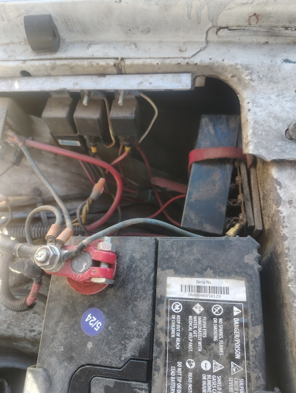

Another thought about electrics since I believe you know more than me on that haha. If I can't make my AT1 system work, where would I hook a wire and or switch to run the fan motor? Through the fan relay? I think direct to battery may cause problems.

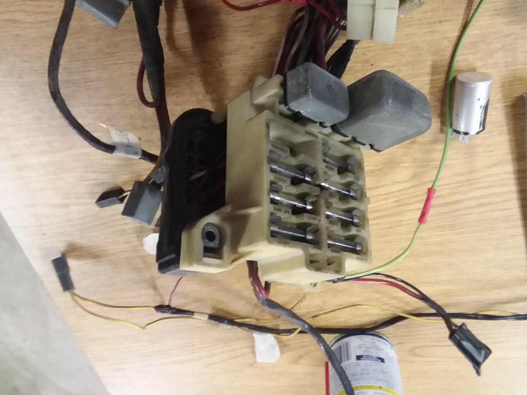

DON'T FUCKUP THE FUSEBOX WITH SOME COTS* generic replacement. Those old glass fuses were actually designed to a tighter specification than the modern ones. You can even pug circuit breakers into the 1.25" x 0.25" fuse receptacles. I have a Better Bypass for feeding the fusebox from the battery, eliminating the alternator charge loop from going into the passenger compartment AT ALL, enhancing safety, but again, some purists shrink in "HORROR!" from the notion of breaking Sacred Tradition.... Another thread.

I'm only bypassing the two burnt spots/wires into a new fuse box.

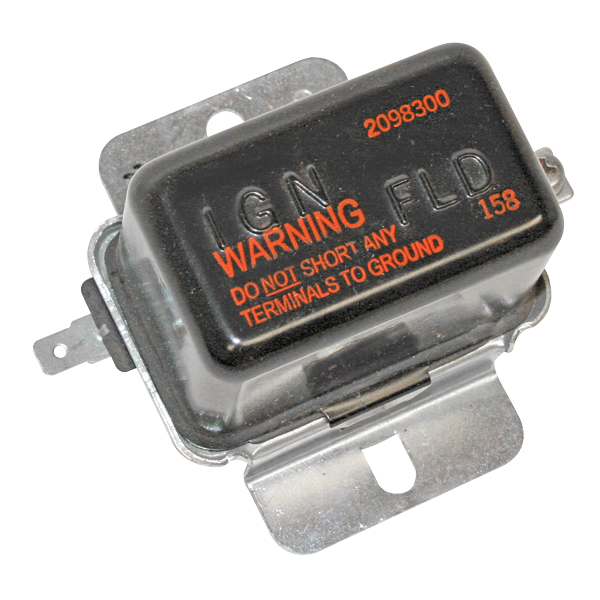

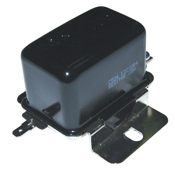

Hmm, OK, the VOLTAGE regulator likely as not is solid state, made to LOOK like the old school stuff. Here's a fair sample of those:
I chose this brand, Regitar because it's common. One of our most redoubtable fellows in this Forum sells (or sold) one like this. Damned tariffs! Prices have DOUBLED in the past couple years....
Here's an NOS sort, the real "old school" sort, though of top quality:
I looked at what NAPA offers, and am outraged by their overpricing! Be this as it may, they're selling what looks like a faithful copy of the old school stuff. Since you got your alternator from them also, I expect it to be either a 35 or 46 amp one, IFF they advertise truthfully.
To be clear, are we talking about a cooling system fan at the radiator or heater blower motor?
If your 1969 fuse box has these 2 spades, right side spade is ignition run. As long is it has good current, auxilliary fuse box should work OK.
