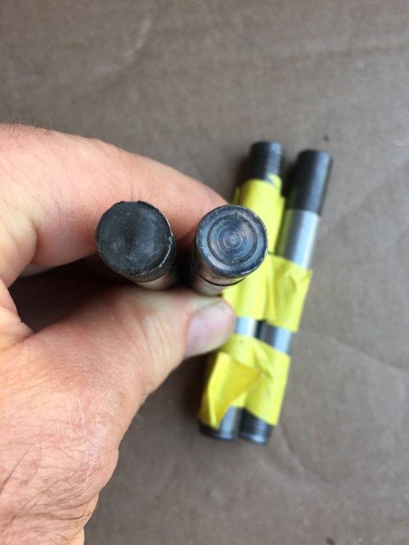

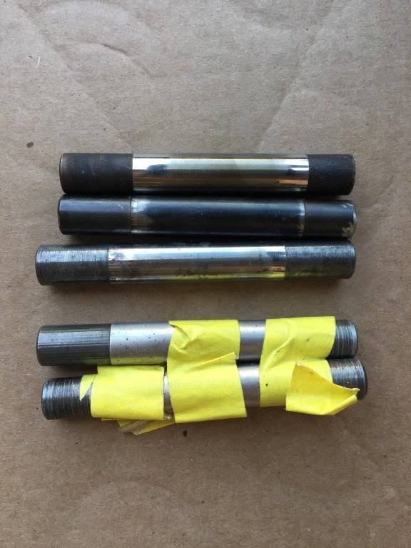

Pushrods. Two badly worn, three NOS.
The push rod is what pushes the fuel pump arm by the rotation of the cam shaft pump lobe. It is located by removing the pipe plug in the block below the fuel pump mounting boss.
Many times the rod will be stuck and need to be coached out with needle nose pliers. The rod needs to be free to move and rotate easily.

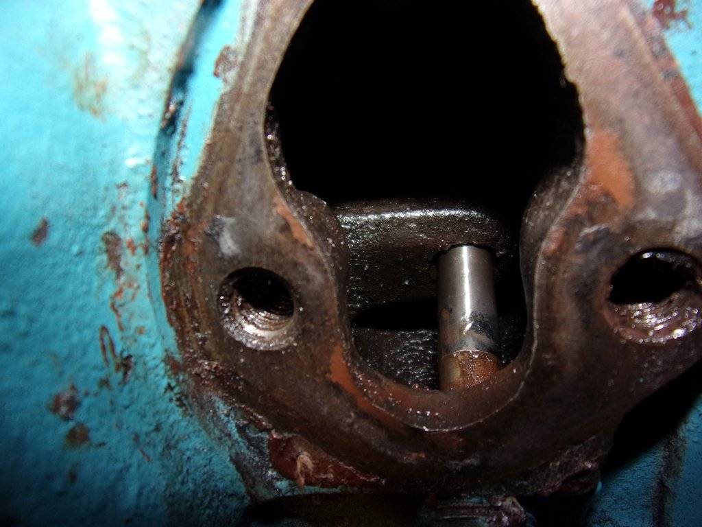

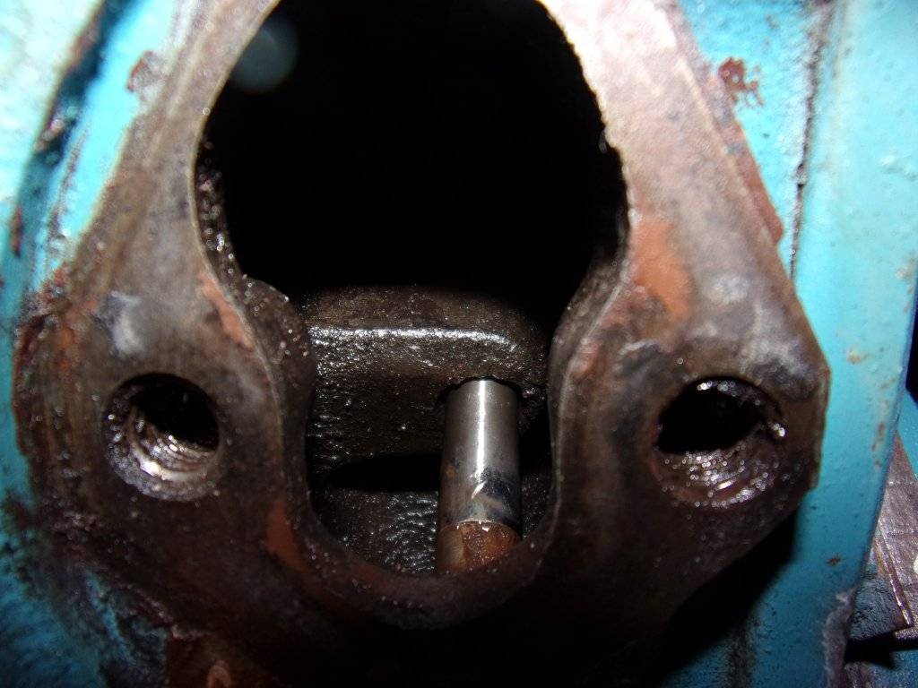

Well, OK, but with the 383, the pump would not insert and seat unless I pushed the rod toward the cam and quickly inserted the pump. On the 413, I don't recall pushing the rod toward the cam before inserting/seating the pump. Here's the best photo I could get. The rod does seem a bit off center....
Thanks for the photos. Yes, I forgot about the boss there. You can push it up and smear a gob of wheel bearing grease on it to keep it in place. Photos are really important to understand the issue you are having.

Thanks Mike. But, still, the rod does seem to be off center with respect to the mounting flange, and the lever on the pump unit is centered on the flange. What's up with that?
John Kirby
Jun 3, 2016
282
150
Minneapolis , Mn
I suspect the off center issue is the same as with lifters and cams. It's done that way to get the pushrod to spin slowly. Lifters do this too so they won't create a worn spot. Assuming you have proper oil flow to everything. I found out about this when I thought I had an issue with my cam being off center. Talked to comp cams and they said it's supposed to be that way. You don't want them to sit centered on the cam lobe. Never would have guessed that but it makes sense once you hear why.
