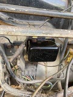

I have a 66 Sport Fury with a 66 383 from a Dodge truck. Ignition was upgraded to electronic by previous owner. I have problems with it stalling at stops and turns and bad missing.. I know I need new plug wires, but I have a new regulator that is two wire. I don't know if it has a ballast resistor or not. Do I need a ballast resistor and a one wire regulator and would these be tha cause of the stalling and missing. Does the ballast resistor look like the one on the 70's Mopars? Any help would be appreciated. Thanks
Mopar electronic should run a ballast resistor value depends on which ECU it is. Stops and turns sounds like a fuel issue to me doubt ignition would do that unless something is loose. Define one wire regulator or do you mean a ballast resistor?
Distributor is a GM style HEI unit, I have two wires running off the regulator, one on each side. I've been told the GM style units don't have an external ballast resistor and I need an electronic regulator with the HEI didtributor.
gm UNITS DO NOT USE A BALAST. Have a picture of your voltage regulator?
Here is the regulator

What other regulator is there? Is there one in the distributor?
No regulator in the distributor, a ignition module in the GM distributor. Mopar electronic distributor uses the firewall mounted module and a ballast resistor to cut down the voltage to the coil.
The electronic regulator reference may be for the alternator, your regulator looks like a mechanical regulator. The electronic regulator may be suggested because it may provide more even voltage than the mechanical regulator.
The GM distributor wants a full 12v
