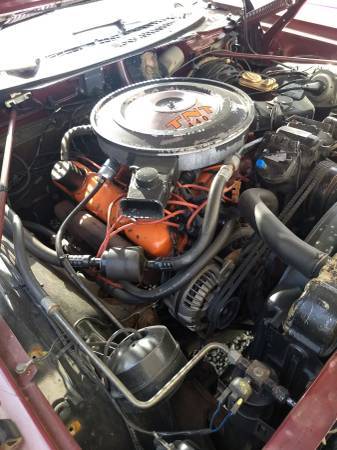

my 70 300 TNT engine's block is orange
snorkels..... I thought the TNT were different color than the NON TNT....
No,yet it is easy to think that as I mentioned,A/B HP engines are orange. (Ditto E bodies for 70 with some minor exceptions)

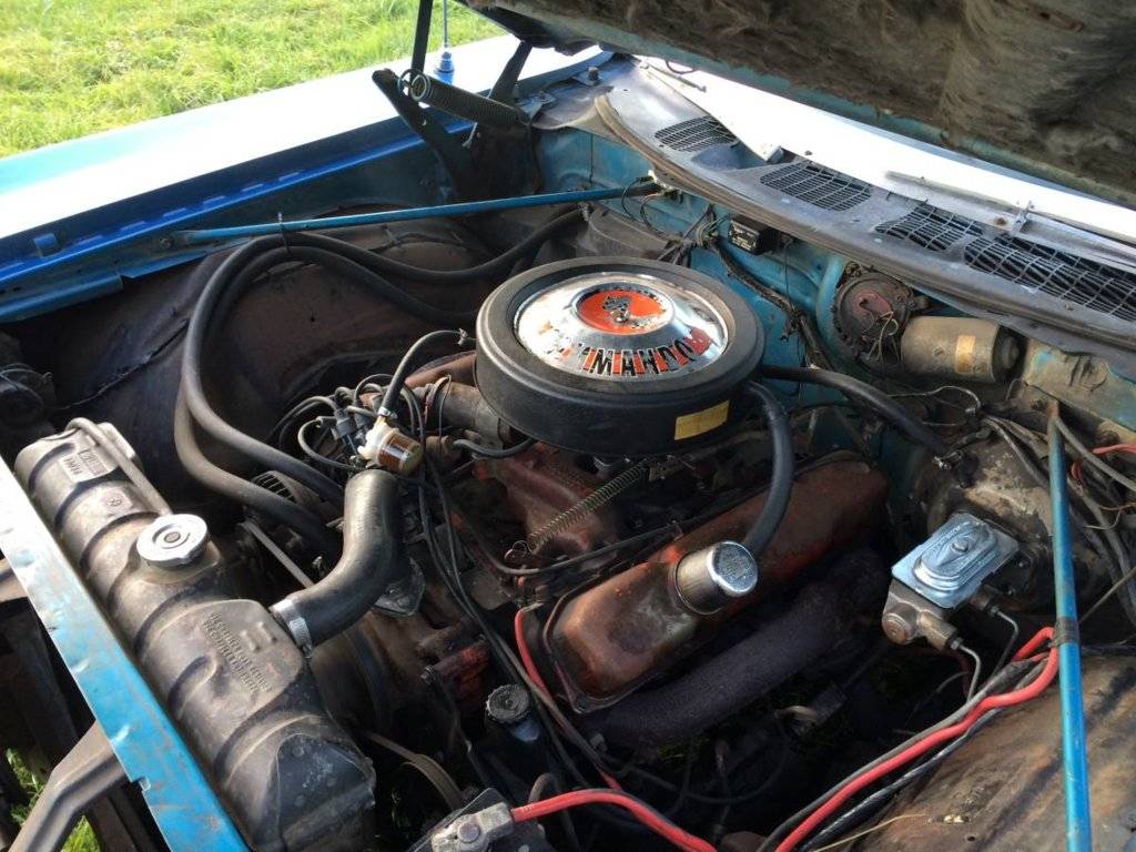

Color Reference Pic is of my 68 383. 69 had the breather hose nipple relocated from the snorkel to the body of the cleaner.
Anybody who has a 69 please chime in,cheers.

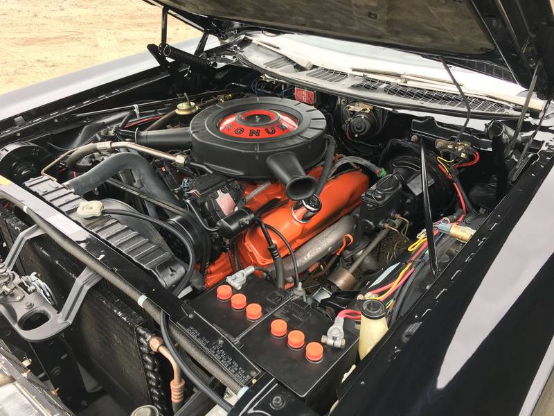

I've been looking for the documentation but haven't been able to find it yet. I'm fairly certain I had some that indicated all L code 69's were Hemi Orange. I know mine is and it's the original engine, never repainted. Having said that, mine is also a Plymouth Sport Fury but I believe it was L code engines, not related to Make. Same would be true for HP 383's if memory serves. If I find the document, I'll share it.
Just saying in the off chance the nasty old battery cable is OEM. It should have the original paint color on it.
