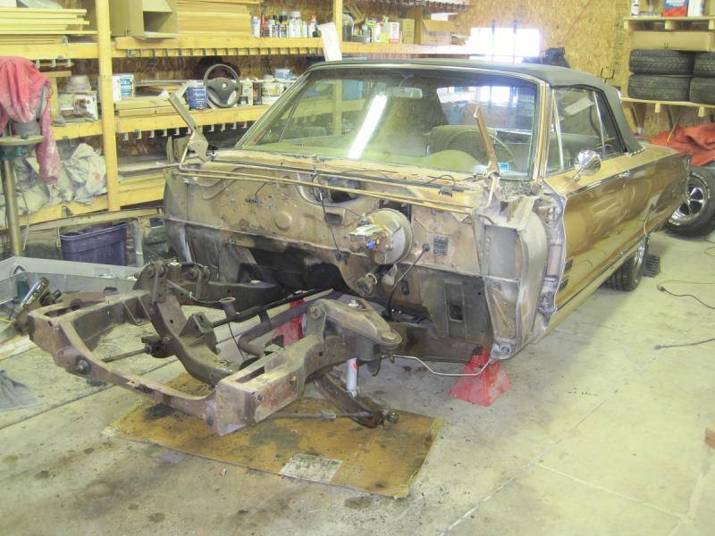

I realized I started several different threads asking many questions on restoring the engine bay. I decided to start a new thread covering the whole process. I have been in the disassemble process so far. Today I took a snow day from work and spent a good portion of the day in the shop.
I finished the removal of the front clip. Scott (Rexus31) highly recommended that I remove the front clip, to do the restoration right. I was reluctant but realized he was right once again. I removed most of the suspension also today, except the items I need special tool to remove.

Looking good Mike! All you need to do is get that master cylinder out of the way and you are good to go! I would also unclip the bulkhead connector and drop it in the interior. As for the steering column, I would leave it in place for now and remove after you paint it. That way, you don't have to block the hole from the inside and can install a new foam gasket for the steering column after paint. Detroit Muscle Technologies should have these as I sent him my originals to use as a template. I would also remove the wiper motor and any nuts that may be securing the heater box. You can repaint the wiper motor yourself or send it out to get rebuilt like I did. There should also be plastic retainers coming through the firewall that hold the firewall insulation in place. You can either mask them real well so they don't get painted or cut them off and install new ones from inside the car. There may be ones behind the heater box that would be tough to get to so masking may be the way to go. The fasteners look like this and are also sold by Detroit Muscle Technologies:

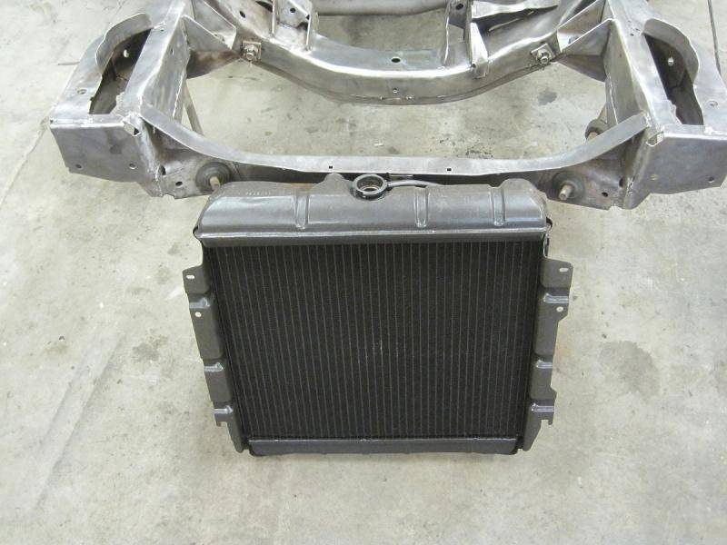

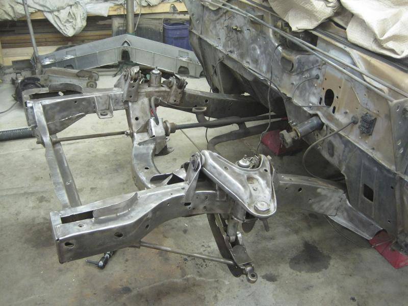

Happiness is nothing but surface rust. I had a good day in the shop today. I got most of the rust on the frame ground off with a braided cup wheel on my grinder and then sand blasted the areas I couldn't get to. I ran out of medium so I didn't get it all done yet. I also got my re-cored radiator back from the radiator shop

Gorgeous!! Thats what a radiator should look like........... Have I ever told you how much I love your car? :love7:
My hands are aching just thinking about all that wire brushing. Great job.

My hands are still vibrating and it is amazing how the medium from the sand blasting is everywhere in the shop and on me. I've learned to wear a hoody that I can draw up tight around my face.
