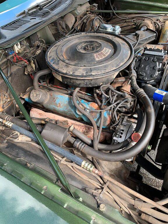

So, Esther's engine bay needs to be cleaned up so I could show it properly with the hood open. What can I use that will not further remove any of the paint from the valve covers? You can see there are a coupe of places where it's flaked off over 47 years. I am guessing the firewall is covered in undercoat? I can see where if I clean the air cleaner it'll look better, but not so much the rest.
I've read through some of the other threads on cleaning, but don't want to have to repaint anything, if I can help it. I don't feel comfortable taking it to a self-serve wash and hosing it down as I don't want to disturb or damage any of the wiring, etc. What can I use the try and clean by hand and not make such a big mess?
There is a detail person who I have wash my 2018 Camry; guess I could call him and see what he recommends... I trust him as we works on high-dollar cars locally (Ferraris, Mercedes and a nice '86 BMW 635 CSi).
Thanks for any input, and if someone is local to me in the Pinellas County area who can help, I would be extremely appreciative! Looking to debut her at a local show on November 14th, which is, alas, a judged show. I'd like to present the car as original/preserved, but not looking like this!

I agree, but in a judged show, I don’t want to be embarrassed when I open the hood. If I ask for them to remember the car is original, they may take that into consideration. I’ll clean the air cleaner at least.
I did find some factory markings in the engine bay, though.
I don't see an in-between, clean it or leave it. I do not see a way to clean it without disturbing the flaking paint.
Yes some paint is going to come off, you'll be surprised how much stays. Take pictures first, I just don't see to thinking people have on trying to preserve some things.
