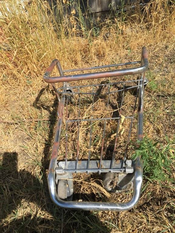

I made a cradle for both engine and transmission this past spring when I scored a 400 which I hope to rebuild for my 66 Newport. I used a big, heavy forklift skid built on 4x4 beams and 1/2" all thread, sheathed in 1/2" EMT for the 8" solid rubber wheels I put on it. I used a cut down shopping cart for the rear end. Moving the combined weight of engine + tranny still is no trifle in this MUD resulting from 6 weeks of non-stop rain. Its as bad here now as it ever was for me in St. Tammany Parish in the longago.
I cut and screwed together a heavy wooden V frame to hold the mounts in place. I've NOT yet been anywhere close to firing the motor up, and I plan to get a proper engine stand to work over engine and tranny separately. Be alll this as it was, I spent only ~ $40 on the material for my cradle. In a pinch, one might use a large old tire to hold the motor up....

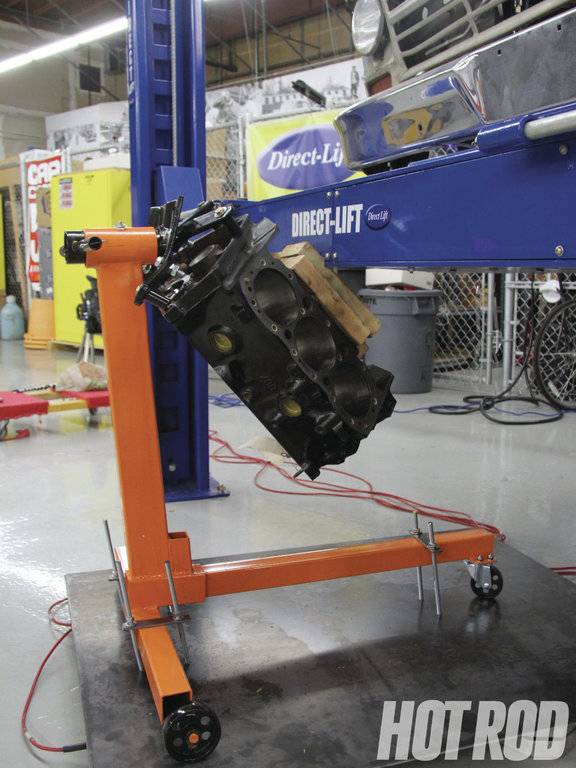

Very misleading! The picture doesn't tell the story of how the engine ended up in that position. The wooden blocks on top of the engine do. A device, probably the lift in the picture, was used to push down on top of the engine until the stand collapsed to that angle. Even the cheapo Harbor Freight engine stands will hold a big block engine up for years.

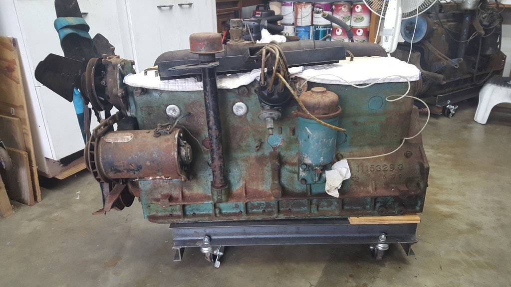

I have two engine stands. One is a generic 3 wheeled stand that I bought over 40 years ago. I've had complete (carb to oil pan) 426 and 392 hemi engines on it and it worked fine. The problem was you could tip it over if you weren't careful. I never did.
The other is a folding Harbor Freight stand that has 4 wheels. I bought that when I did my flathead six for my Windsor. I had torn down a similar engine on my 3 wheeled stand and it seemed a little unsteady because of the length of the heavy flathead. I like the HF stand much better and the 3 wheeled stand was taken apart and stashed. I'd use the HF stand again in a heartbeat.
