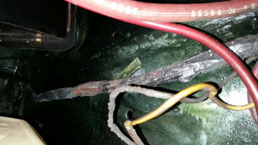

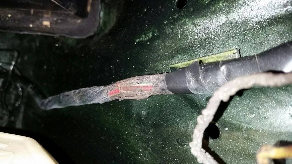

"My wire harness isn't that pretty and in some spots the insulation is bubbled and burned."
Is everyone missing this?

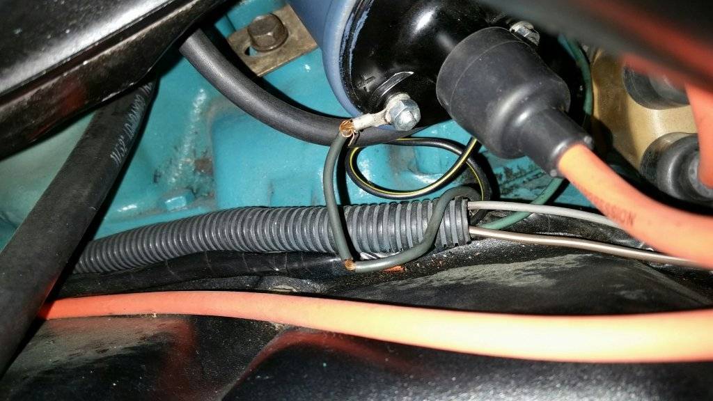

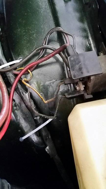

Sorry for the long reply, ive had some network issues over the past few days. Anyway heres some pictures of my harness. It is really bad at the starter relay and near the headlights. Also I was peeling back the tape for the coil leads and the positive lead is really dry rotted. I do have electronic ignition so the negative lead is good. My phone camera isn't that good but heres some pictures of bad areas, as you can imagine most of my harness is like this.
This is probably whats causes my high beams to shut off randomly. Also my cousin has a 68 300 parts car with a good harness. It was a low mile car that had the engine pulled for years and has been in storage. I think i might be borrowing a harness from him!
