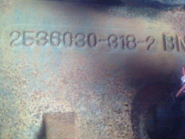

    On the driver's side the whole cast number is:
    2536030-318-2 BN

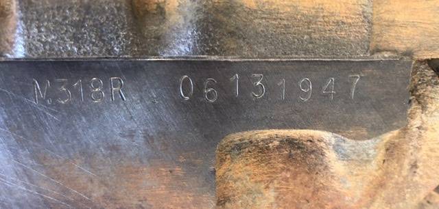

    M- Mount road plant
    318 - displacement
    R - regular gas
    06 13 - month and day engine assembled
    1947 - sequential number for that day
    There should be another letter before the M to give us the year of the engine. Plus with the 1283, I think a pic of this will help us work out what we are seeing here.

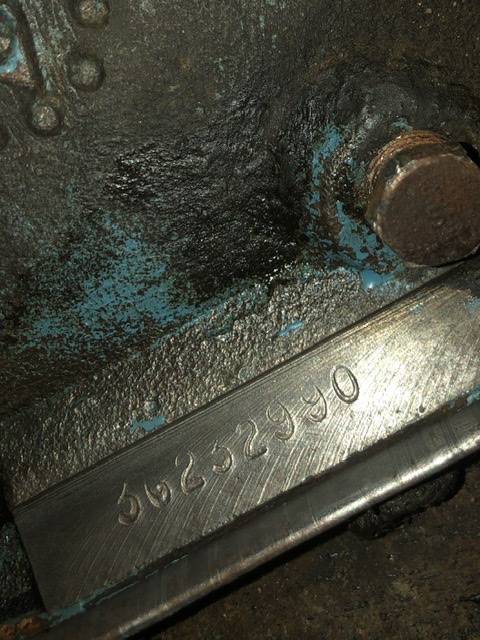

    ok, I did some digging (and cleaning) and found another piece of the puzzle. Just below the drain plug on the passenger side there is another imprint reading what looks like:
    36232990.
    Photos of all to follow

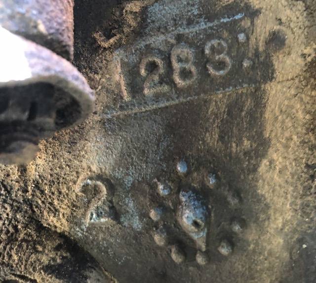

    3AA34342-E13A-4FDD-8662-EC016E5B48DD.jpeg 70BA6D94-77F1-4720-B7BA-7A1AB57657E6.jpeg These are the numbers on the driver’s side-the 1283 is to the left (closer to the front) of the longer number

    C19ACEE2-4834-4C31-9911-B343A3EA626E.jpeg This is the stamp on the front of the block, driver’s side behind where the power steering unit mounts. As you can see it doesn’t look like there’s anything before the “M”. No sign that I can see of any remnant of a letter.

    0ADABF7A-67A7-4070-83B9-8D1D6A33A4C2.jpeg 504B9B29-A8B4-4598-A0B5-7178F0BEBFD2.jpeg These are the markings on the passenger side of the block. Again, the 1283 is on the right closer to the front of the engine and just to the left of the motor mount.

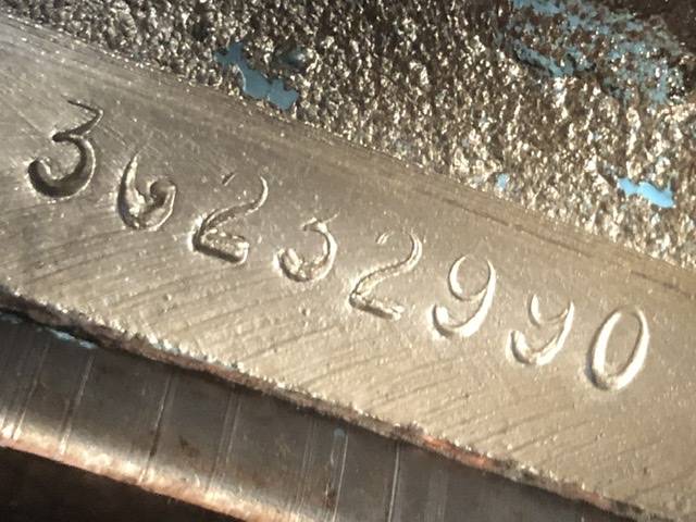

  12. Rosco
    Rosco Member
    Messages:
    154
    Likes Received:
    1
    Joined:
    Jan 8, 2020
    Location:
    Todos Santos
    23C1BCBF-4A33-4874-B768-844F101DCD72.jpeg 098DEE08-10E5-405D-B2E4-90EAA8C94632.jpeg Here are a couple of views of the stamp I discovered on the passenger side just below the drain plug. It appears to read 36232990

    That’s 3G232990 I think in which case this is likely removed from a ‘73 model built in St. Louis. The block casting number is that of ‘67-75 318 and that VIN on it would mean it’s ‘69 or later.

    What do you make of the stamp on the front of the block? Starts with M but most folks want there to be two letters there before the 318 mark.

    that’s the VIN number of the car is came out of..
    1973 n
    Model year, built at St. Louis plant. Could have come from either a B or A body.

    1283 maybe 1-28-‘73 or 12-8-‘73.
    These cars and parts are going on 50 years and people have been swapping parts on and off of them out of necessity for almost the whole time.
