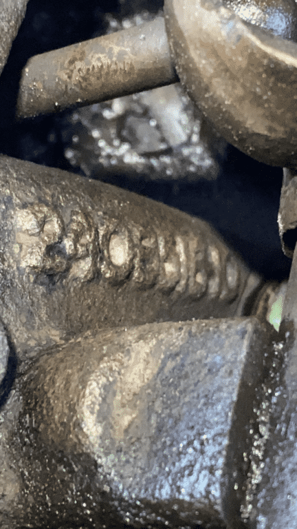

Hi there, currently my car motor is in bits at my local garage. The mechanic isn’t convinced the engine is a 383 as we’ve always thought. He reckons the number in the pic reads 2408518 10.... any ideas would be really appreciated. Thank you.

That looks like the cylinder head. If so, here are the head casting numbers...
Mopar Casting Numbers - MyMopar.com - Mopar Part Numners
Check the numbers more closely. The casting for a '67 B/RB head is 2406516 (there are sixes where you have eights 2408518), and because they are used on all the B/RB blocks, you won't be able to tell specifically what they were on.
The block casting numbers are here...
MyMopar - Mopar Forums & Information - Mopar Engine Casting Numbers 1959-1978
Also check the block ID pad. Look at this post to see where they are...
Big Block Engine Identification through pics
If it's a 383, there is an ID pad to the left (passenger) side if the distributor. A 440 will have a ID pad to the right of the distributor.
The displacement is also cast into the driver side of the block, behind the starter location. Example - 2536430 440 (casting number then displacement)
@patrick66 that casting style started in the mid 70’s. I’ve never seen it on a 1972 and older block. There is no block From the 60’s that has the cubic inch cast after the part number.

When all else fails, check the piston/bore diameter. IF the carb and distributor are the ones the car came with, those numbers can possibly be easy to track in a factory service manual or other service/parts literature.

Hi everyone, the mystery continues but your response has helped us establish it definitely is a 383..... thank you so much...
