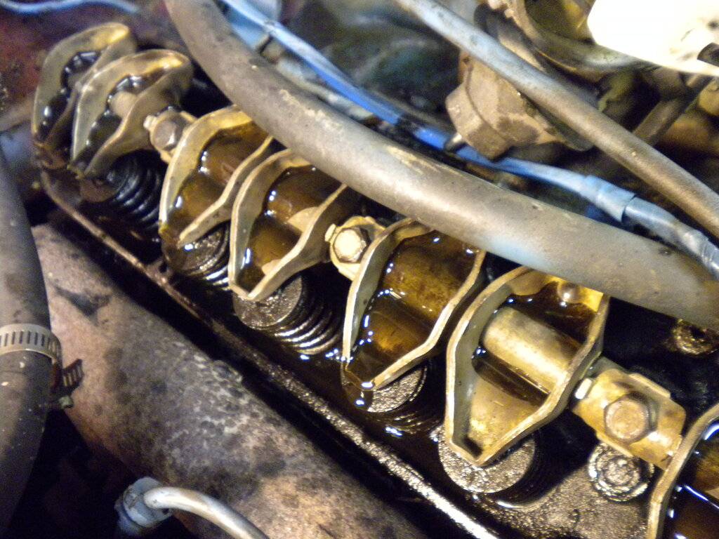

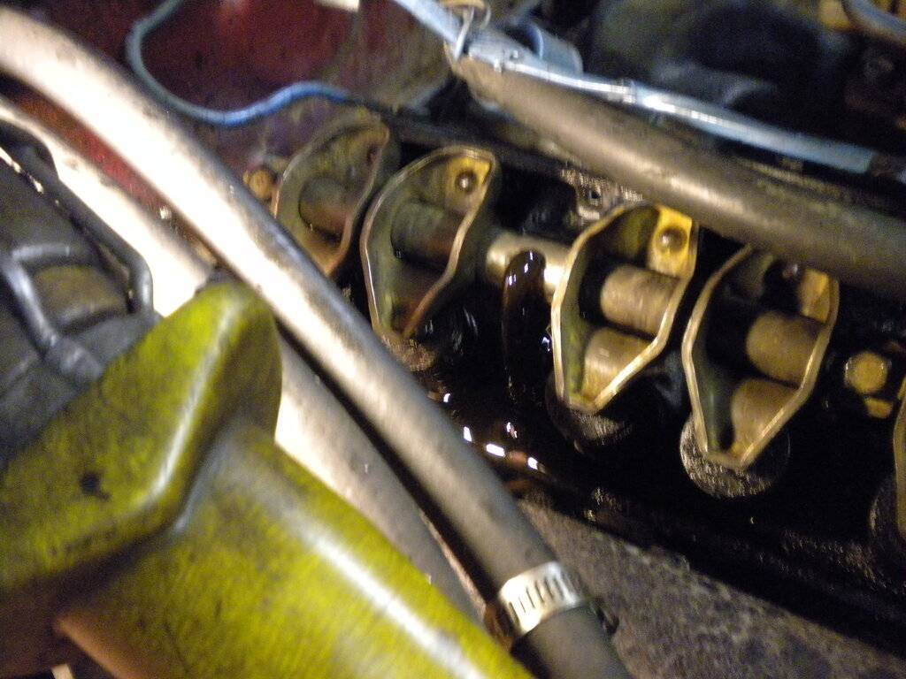

Should I expect to see oil at the rocker arms while manually priming a 383? I've got good pressure at the lifters, none coming up through the oil galley to the rocker shaft.
Thanks
Will.

Looking at the diagram in the service manual i'm pretty sure the engine needs to be rotated to feed the rocker galleys.
All's good, I think. (except for the push rod I bent reassembling).:BangHead:
you'll know when it's in the right spot. different positions for each bank.
