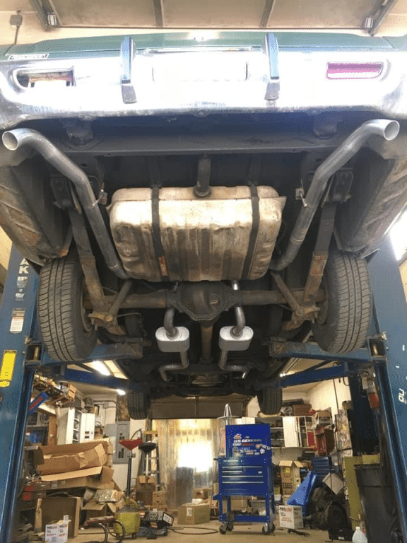

Hi all, I love my 77 NYB I take it everywhere all over New England. Has about 80,000 miles. I have dual 2.5 inch exhaust on it. Looking for more of a punch from the 440. Obviously reliability is a must for me on long road trips but she just seems to fall flat on her face. Looking for some performance upgrades. The lean burn is gone. What should I be looking at to install? Thanks in advance!

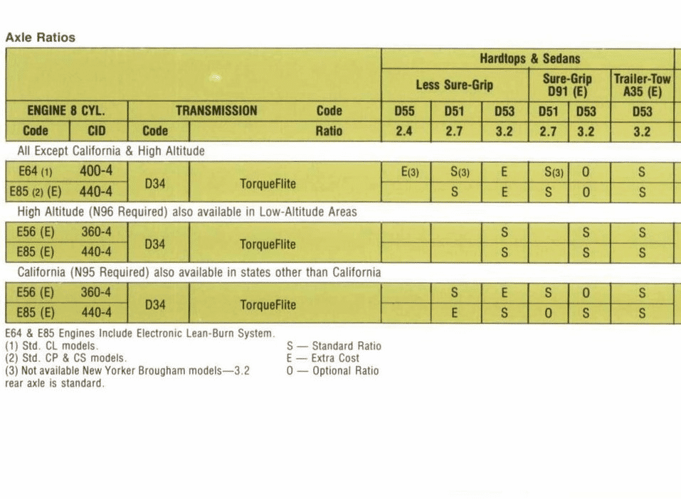

Beyond that, I would look into different gearing, assuming it has highway gearing, say, 2.71:1. A big, heavy car like that needs some help getting moving and lower gears help. It could even improve gas mileage. If your exhaust is 2.5" all the way back that could be hurting the bottom end as you don't have enough flow to warrant the pipe size. Does the exhaust have a crossover pipe back near the tranny?

Negative. Do believe it has the highway gears. I do a lot of long distance trips, would the 3.23 hurt me on the highway?

3.23 gears will help a bunch.

2.5" exhaust would handle 9.0:1 compression which would be a big performance enhancement, but would require rebuilding the engine.

No h pipe on the exhaust, the 2.5 size is fine, quit over analyzing as the real details get run over as always, just look at a brake thread where so-in-so is so smart and rest of us are just ^%&*(!
Needs mopar oem type hemi mufflers or better yet the c body version

3.23 gears, but since your car doesn't have a 8 3/4" drop out center, and setting up Spicer gears properly can be costly, it would probably be cheaper to buy a complete rear end with the 3.23s. Add a non-emission 4 brl carb, re-curve dist, valve job or at least new stem seals, and likely a new smaller performance cam for the low compression era motors like a Lunati Voodoo. Your 80k motor cam is low perf and probably worn out, as most of the ones I pulled out of similar era motors that I used for rebuild cores with as little as 50k miles were shot.

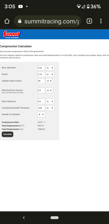

well all i told u i did on my 72 smog 440 i rebuilt it to 71 specs . i had a set of heads that was all ready milled 25 thousands i cc'ed the heads that was 90cc's (i was told with the block i had the heads would make it 9-1 compression motor i also added a windage tray &a double row timing chain the oem chains r only good for 90-110k miles then i added a Mopar performance resteration cam the had already had the battleship double springs good for .500" lift . i trashed the Holley & put on a 750 cmf carter carb from a 71 440 new yorker . it has 2.76 gears in a 8 3/4 "banjo" rear end . now if i had put in a 3.23 gear the mpg's would had droped to 10 on the highway. its no jack rabbit @ the traffic light but it runs out ok i wish the mpg's would be better

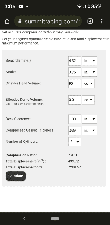

Milling the heads is useless without milling the deck and a piston change. Now you are into a complete build. Any pistons you are getting off the shelf that don't cost $800-$1000 a set are going to put you right back in crap compression ratio. Someone mentioned milling the heads to 90cc hear is what that gets you if you also deck the block to 0.0 and use stock cast type pistons.
Here is what you really get from the average mid70s 440 or 400
Now you could mill the heads and replace the pistons with some KB step head pistons and you might get to 9+:1 compression, but that's a good chunk of change, a lot of work and probably net you 25-30 horsepower and a mile or maybe 2 pet gallon fuel mileage.
