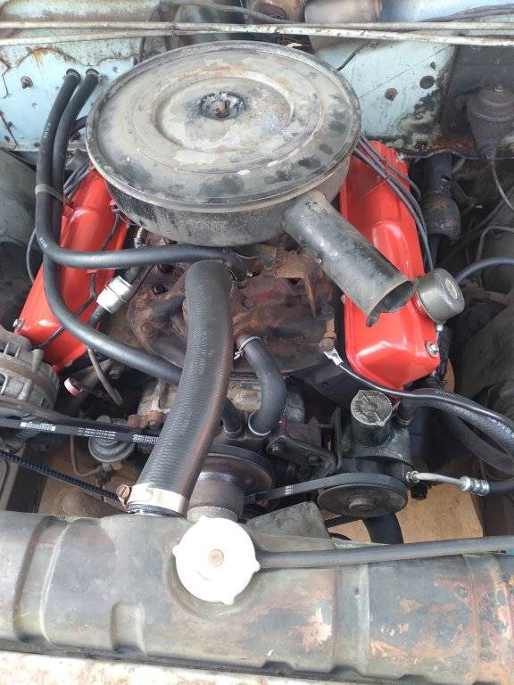

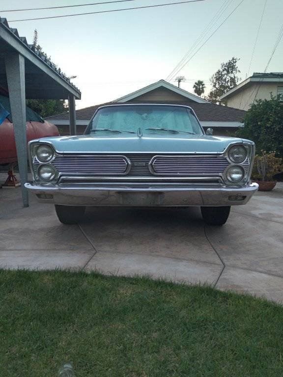

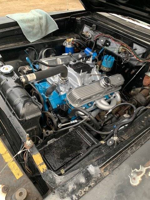

I have a garage find 66 fury III its 100% stock I have done a few things to spice it up like putting new wheels and cleaning up the poly 318 but as it runs great it is quite gutless so I'm on the fence on if I should swap a 360 in because it's pretty much bolt right in or should I go for big block I have a 383 from my grandpa's 72 roadrunner but seems like it would be a lot more work... Any advice
Here are some pics
Welcome.
Slide the Fury under the crane and the SB will literally fall in.
Going with BB is gonna get your hands dirtier.
I vote a built and stroked SB to 400 inches.
You can also opt for a mild build of the poly. Aftermarket 4BBL manifold, mild cam and a set of headers will get you to about 300hp.
