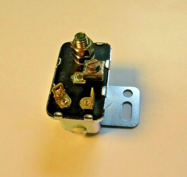

starter relay looks like this:
Bottom right terminal is the wire coming up from the NSS. Since that's been brought up, let's check that first. Disconnect that wire and using multimeter (a cheap Harbor Freight version will do it) check to see if there is continuity to ground when the car is in park and neutral. The alternate test, that doesn't use a multimeter, is to run a jumper wire from that terminal to a good ground and try to start the car.
Now you've probably found that these guys are full of **** about the NSS, so let's go on.
The lower left terminal is the feed from the ignition switch. When the key is turned to "start" position, you should have 12 volts to that switch and you can check that with your multimeter. Alternative is to momentarily connect a jumper wire to a 12 volt source. Happens to be a good one at that terminal on top. If jumper is attached and the engine turns over, the ignition switch (or the wiring to it) is the problem.
Now we check the starter relay... This is probably your problem, but now you know how to check the rest.
The upper two terminals... The top is the battery feed and the one below it is the feed to the starter. You take an old screwdriver and short it between those two terminals. Since you've established that the starter is working, that should turn the engine over. Replace the starter relay.

Thanks to all and a special thanks to Big John for the detailed help... Turned out to be a push on connector on the relay,, I back up and Happy... Dave
I had the ignition lead and the NSS lead both fail on my starter relay in previous summers. Finally, this past Spring, the starter relay itself failed. Its a likely trouble spot for these kind of starting issues. To minimize recurrence of such failures, use some dielectric grease and make good terminations to your 0.25 inch female slide connectors. I might put a good terminal bus on to the battery terminal, as adding a bunch of extra ring terminals there begs for trouble.
