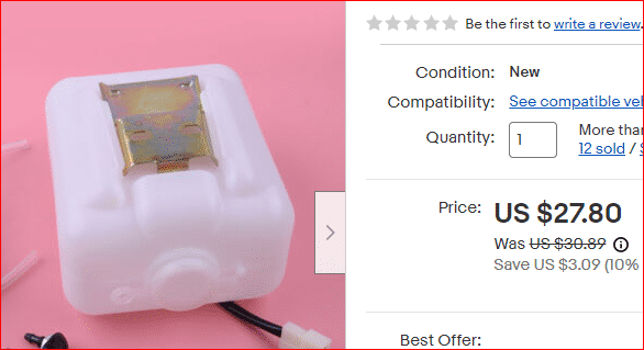

This is an off the shelf washer reservoir kit from NAPA. I didn't want anything too nice so it would remind me to keep praying for a repop.
