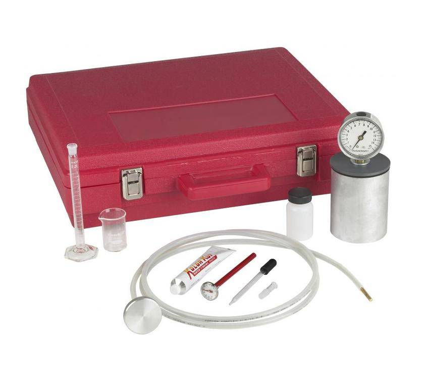

Recently, I saw a kit for checking the level of ethanol in pump gas. It looked very simple to use, basically mix water and gas together and then see what separates out. A little pricey for what it was and I got to thinking about how I could check it with a graduated cylinder.
I got to looking around a little more and found this!
The test kit I found:
https://smile.amazon.com/dp/B073HLS...olid=37FPUUXHT633A&psc=1&ref_=lv_ov_lig_dp_it
There's a good video on that link.
I try to buy non-ethanol gas when possible, but the recent trip to Carlisle made that impossible. The places off Rt 81 don't have anything except the ethanol laced stuff. I'm curious of the percentage when I start putting non ethanol in and it gets mixed.

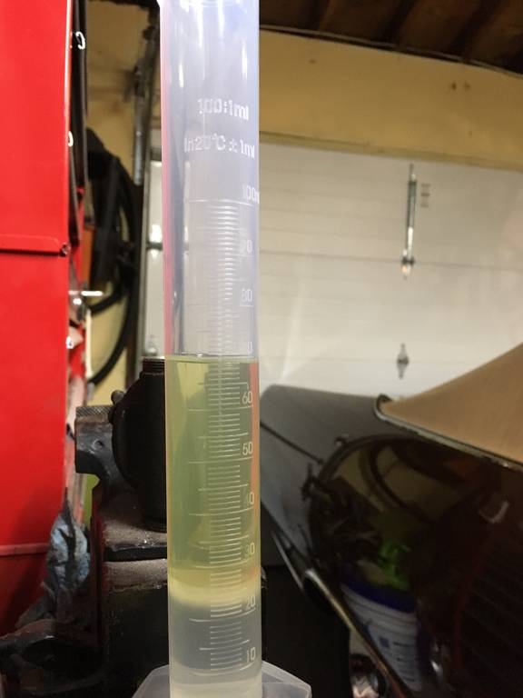

I thought I had a good graduated cylinder, but I can't find it. I'll order one and see what I have in the tank right now. In theory, it should be less than 10% because I started out with non ethanol gas. Two tanks of ethanol gas later, I'm curious what it is now.

So... Checking what's in the tank, I get about 10% methanol.
Good sleuthing John!

BTW OTC has sold a gasoline quality test kit for decades... I believe it goes back to the gasohol days. Remember when warranties were voided by gasohol?
The eyedropper and small graduated cylinder allowed for the same test you did, with a small fuel sample (less to throw away). The water paste and dipstick for the tank was the same idea used to check for water in service station tanks. The reed vapor pressure test, done with the aluminum cylinder/gauge could be used to check volatility... for example winter/summer blends.
This was a dealer tool at one point. IDK exactly when they would have been shipped as a required tool, but I saw the same kits in the tool room of both a Ford and a Dodge dealer. Both were pretty old in the 90's.
I can say from first hand testing, there were lots of E10 samples that tested closer to 20% from certain gas stations 5-10 years ago, when I was tasked with showing how to use the kit.
