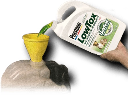

Sorry for the red x Dave... I couldn't let that stand JIC someone took it as gospel... you HAVE to read the labels... color means nothing. I have propylene glycol that's green at work... it cannot be visually distinguished from ethylene glycol.
Somebody may have screwed up, or you may have gotten some blended antifreeze, the green color according to the hazard marking protocol is supposed to contain Ethylene Glycol. This is supposed to determine how it is disposed of.

Broke the seal on the bottles myself... I believe it was this...
edit: I did read the label...
Dave
Green colorant is no longer exclusively used for Ethylene Glycol. This has changed since I retired.
