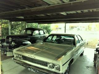

I cannot locate a new Pitman Arm for my 69 Factory RHD aussie Dodge Phoenix (AKA 1969 Fury 111) New Chrysler parts in Australia are rarer than a rust free C Body.
I was wondering if the LHD item could be the same part number or different!!
