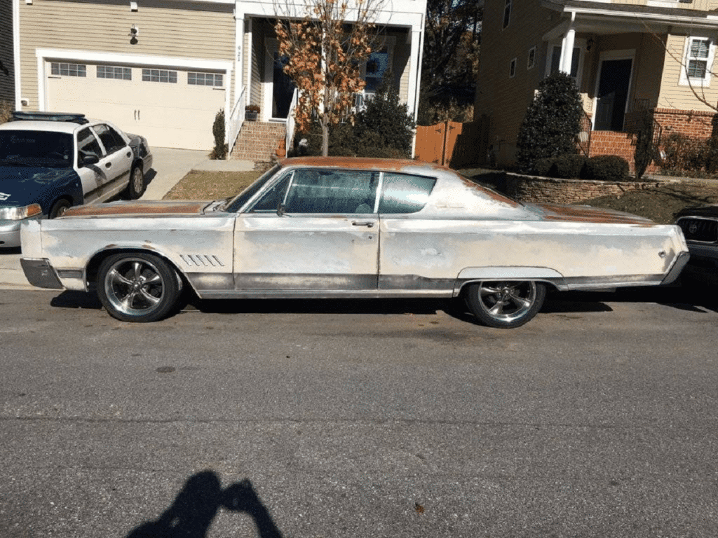

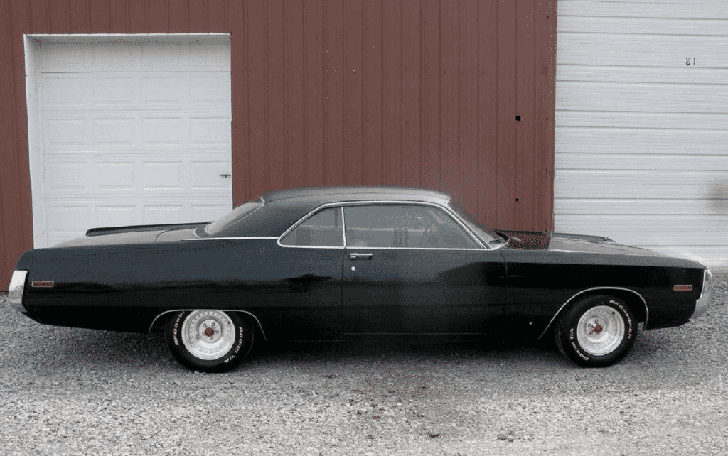

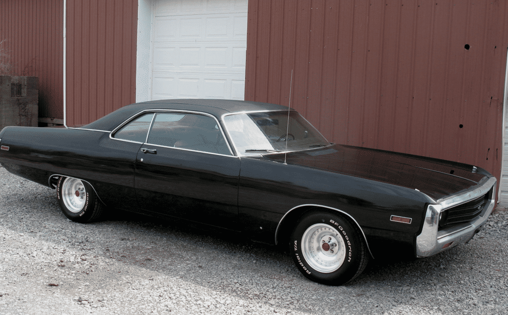

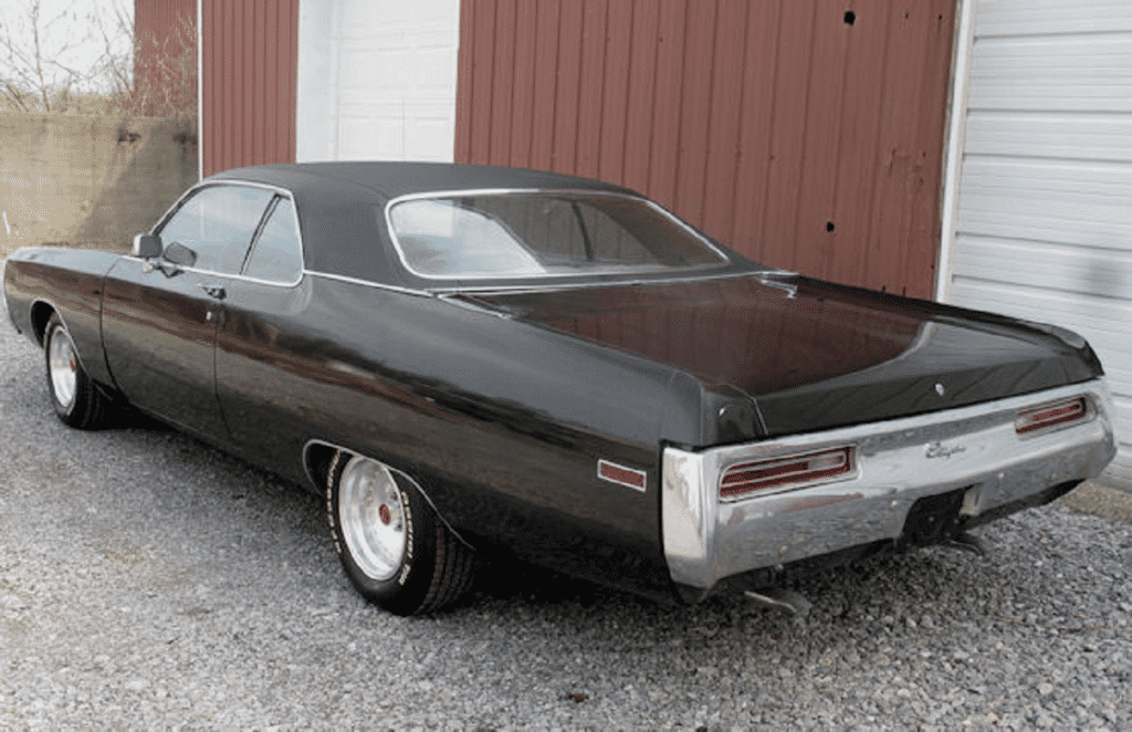

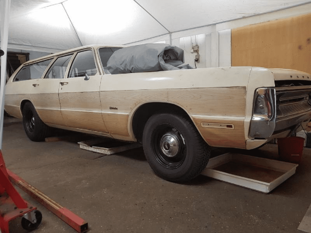

I'll start with one of mine. 1971 Newport, 235/70R-15 tires, 15x8 wheels with 4.0 inch backspacing. Stock front disk/rear drum. No interference, no adaptations.

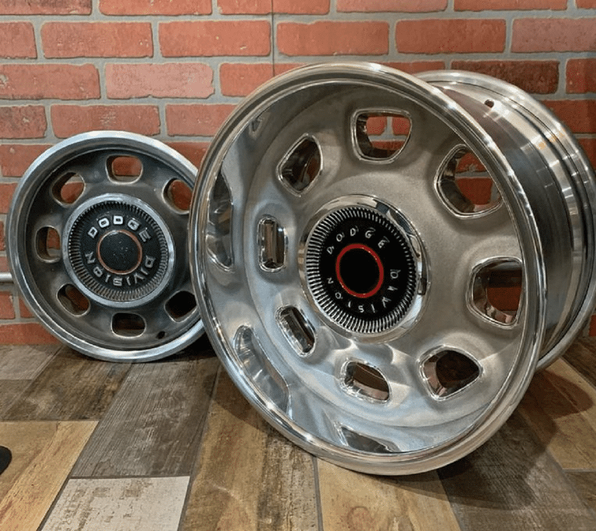

Wheels

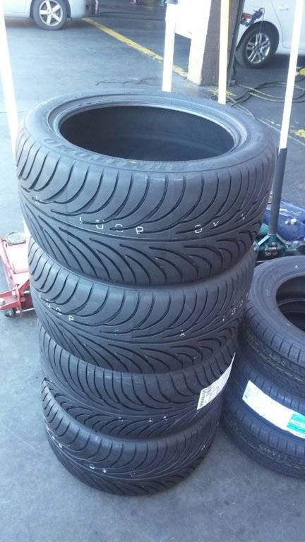

Just posting this for anyone interested in buying aftermarket wheels. I know wheel size is beat to death, but still have to look hard for info. Hope this helps anyone who is interested in wider tires and a different look than stock. I included the stock tire pics and the new ones. The new ones are 18 inch rims, 4.5 offset and 8.5 inches wide. no clearance or rubbing issues.
Wheelswheelswheels

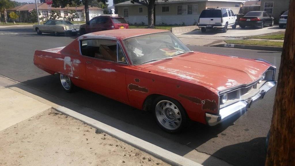

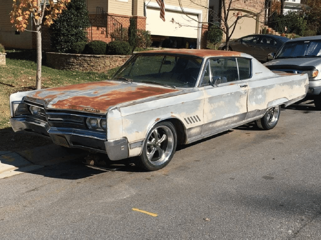

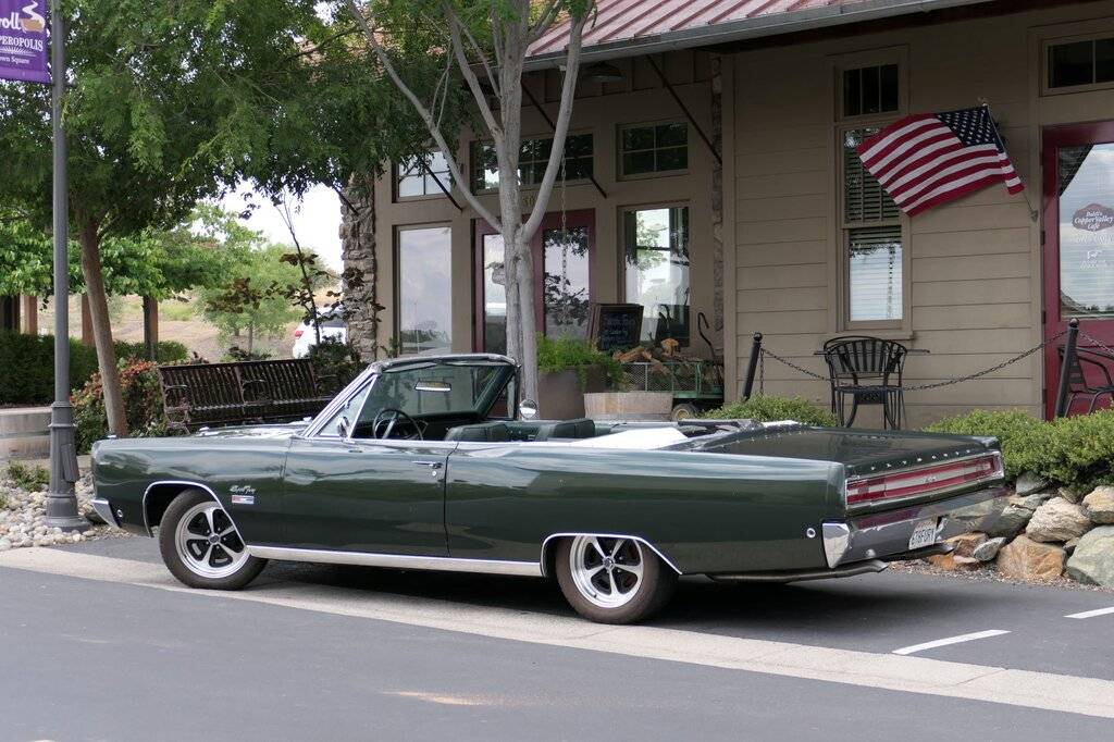

My 68 Sport Fury is stock so I don't need a lot of rubber out back for traction. My car is a cruiser with the stock 383 4bbl running through a 727 to an 8.75 Sure Grip with highway gears. My car came from the factory with 14" Magnums and power drums all around but an upgrade to 73 Chrysler discs up front was done 3 years ago. This also necessitated a move up in rim size. I initially thought to go with a set of reproduction 15" Magnums but I was surprised and disappointed to find the cost was pretty high and tire selection very limited. My Mopar friends pointed me to the American Racing VN501s that look like the Magnums but come in modern wheel sizes with different widths. Again, my car does not need a lot of rubber for traction so I was not looking to put the biggest tires possible under it. I went with the VN501s in 17x7 and I am very happy with them. I could easily fit 8" out back and possibly larger, but don't need to. Also, my car does not have skirts. My tires are a set of BF Goodrich g-force comp-2 and the size is 235/55ZR17. This combo was far cheaper than what I was originally considering, plus it looks great and handles great. The only downside is a slightly harsher ride when you run the air pressure up above 40psi, which is common as you increase the wheel size and reduce the sidewall.
another good example to learn from, but again maybe owner will chime in with backspacing.

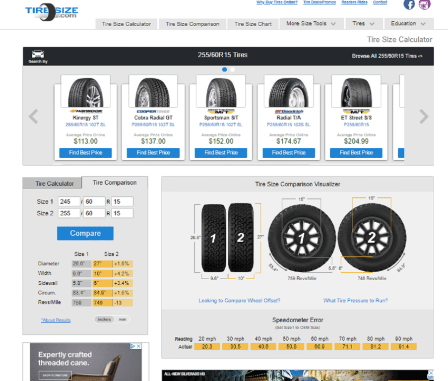

Tangent. Let me interject a teachiing tool (there are lots of calculators out there).
this is a little spammy looking, though i am sure its a fine site, so I will put a screen shot up first
Tire Size Calculator
Helps you plan a conversion, take measurements, judge speedo effects, do all sorts "what ifs", etc, before you throw some money at a switch of hardware/meats.

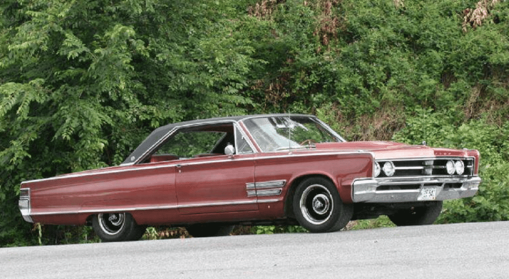

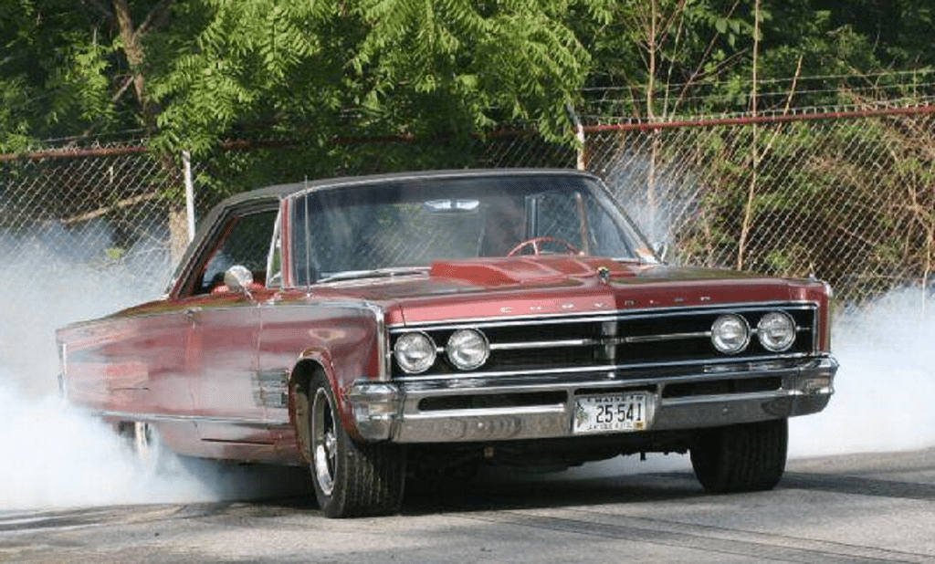

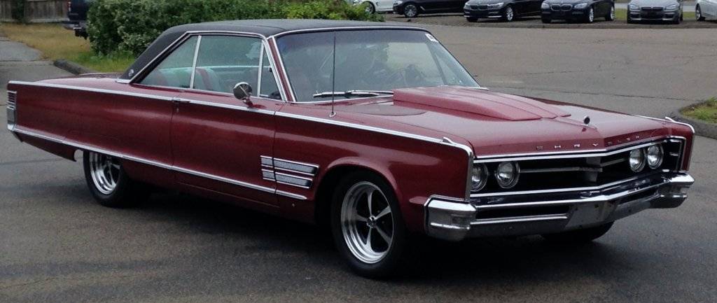

The Flyin' (Flying) Whale ('66 300) Hits the streets again!

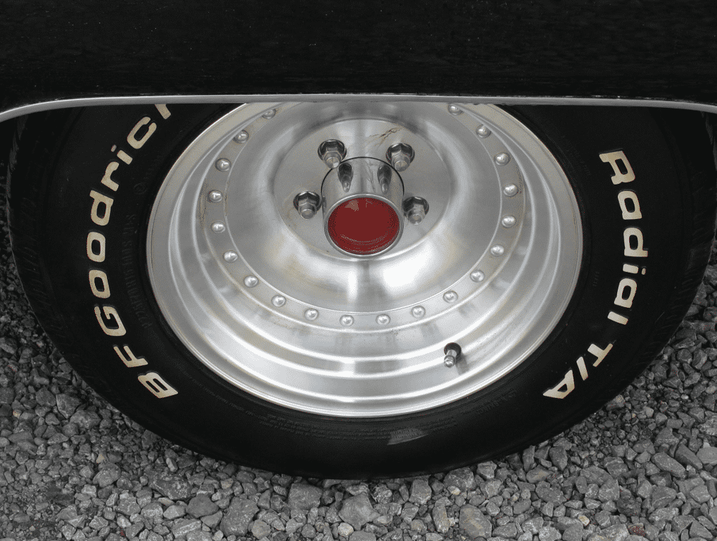

The tires are BFG Radials, 265/50R-16 in the front, and 295/50R16 in the rear. The rims are custom steel rallies, 9" wide in the front, 10" rear, with stainless steel trim rings and center caps made from original 300 spinner hubcaps
The Old Man and the Sea -- as built 2005, heavily modified, to get a 10 inch rim in back with a big fat tire required the leaf springs to be moved inboard 1/2 inch.
So under stock configuratioin, a 10-inch wheel, and any tire that would fit it, probably would not work on a slabbie out back. Might be able to get a nine-inch wheel in front
All that was 15 years ago. When she came up for air over a decade later under new ownership, she got updated wheels/tires
The wheels are American Racing VN501's, 17 x 8 in the front with 255R/50/17 and 17 x 9 in the rear with 275R/50/17 in the rear.
Backspacing not listed, but given clearances for the original 16x9 and 10's, no doubt 17x8 & 9 AR 501's will fit with no issues

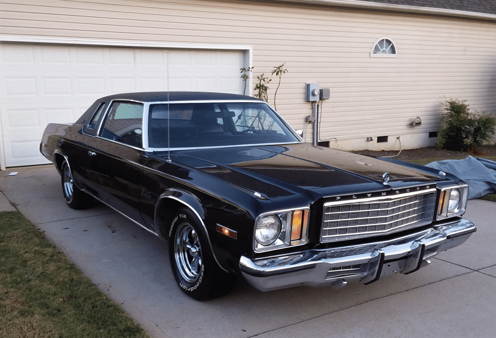

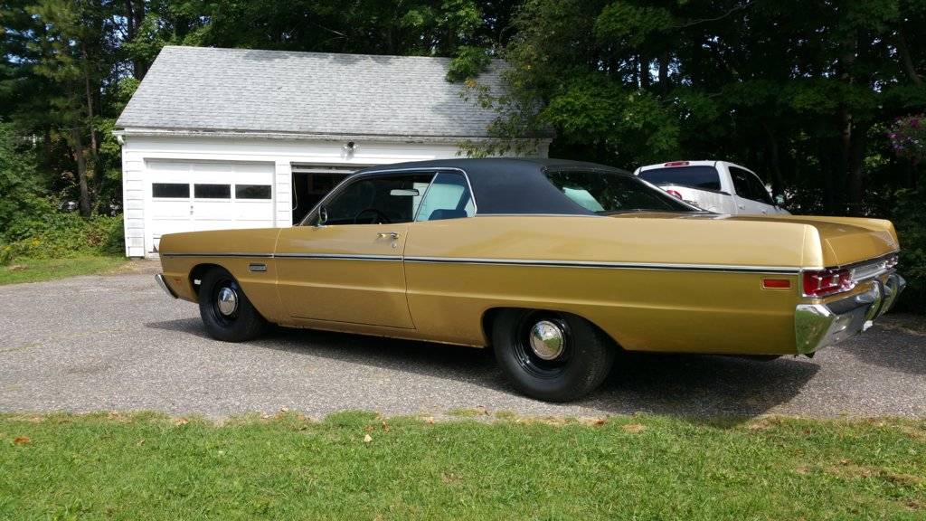

another one of mine. 1975 Gran Fury, 235/70R-15. TT-II's. 15x8, 4.5 inch backspacing. Front Disc/Rear Drum, no interferences, no adaptations.

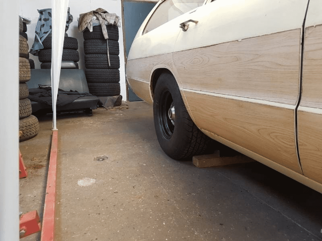

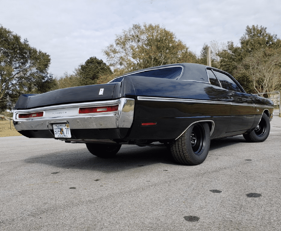

New shoes for the Burbie...
Well, by popular (= 3 or more people) demand; one pic of the Burbie showing both the rear and front wheels. Fronts are factory 15x7 police wheels with standard backspacing, 225/70 tires. The 15x10 ones have 5.5" backspacing.
earlier, OP called out the rear tires as 285/70-15s. No word on any mods or interference.

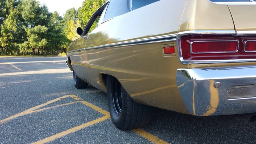

Drive line upgrade
275/60-15's on 15x8 with 4" backspace. I had to trim about a 1/4".
I believe OP is speaking only about the rears. the adaptation was to shave a hair off inner wheel opening -- might mean a little more offset than 4.0 might have worked with that tire/wheel combo?
