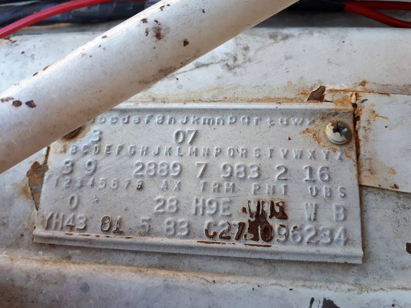

Got a body tag of the car to decipher and had a go myself, seems to tally with the car, but not sure what all the top numbers are about ( below the lower case alphabet and below the capital alphabet)? I can see the paint, engine, body, colour, interior type/colour, when/where it was made.
Here is a pic of it

The numbers below the letters are all individual options such as power windows etc. and it does have the sure grip.:thumbsup:
Thanks guys, limited slip differential as I've just discovered its also known as., good news. Oil brands here probably different, so will look into that, been a long long time since I bought any, been driving modern cars too long.... and let a garage do all the dirty stuff :eek:
