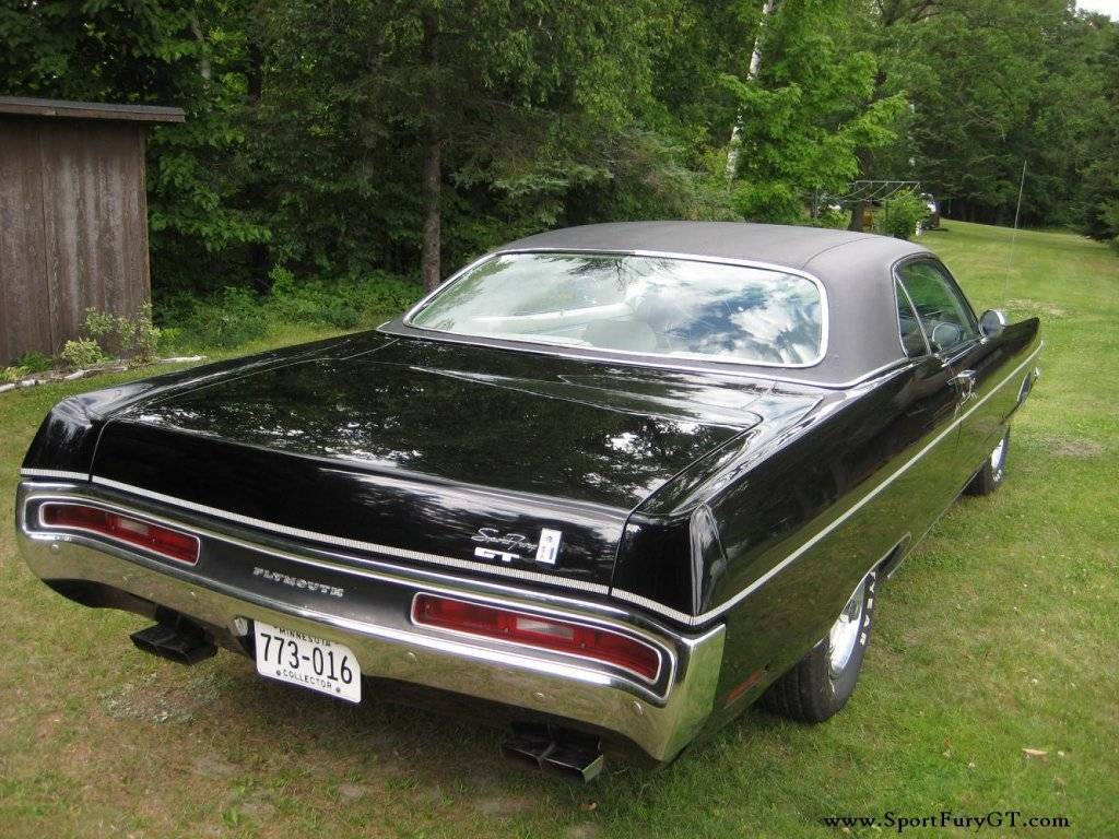

If want to go totally crazy, Sport Fury GT tips.

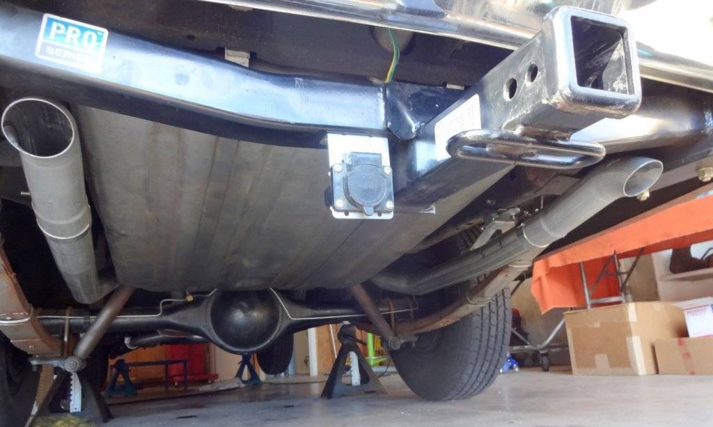

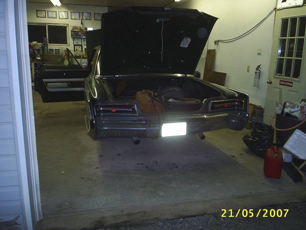

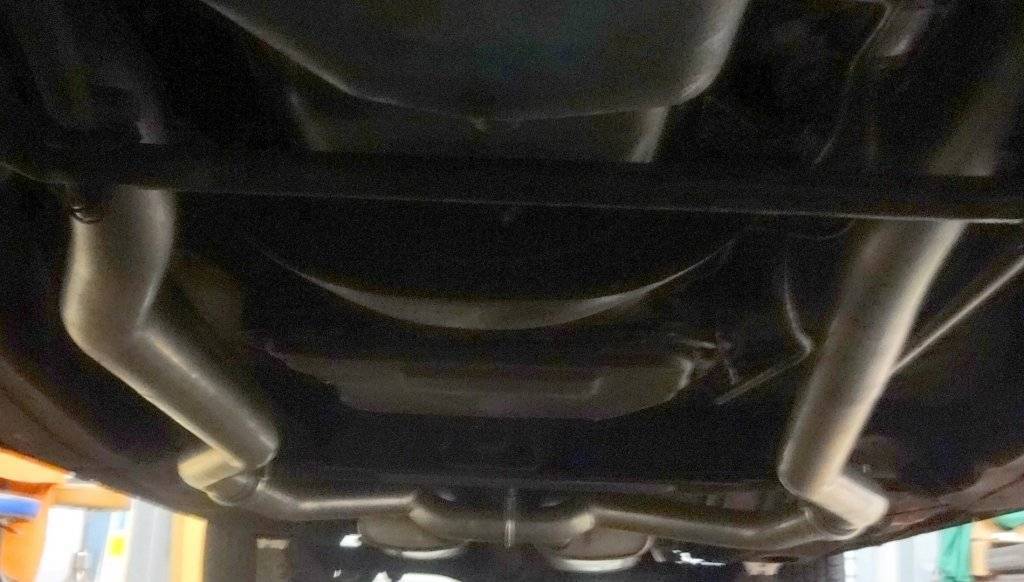

Turn downs just before the bumper is best. You may also want to have a crossover between the exhaust pipes to balance the cylinder pulses. Mellows out the tone.
I shortened my exhaust pipes a couple of inches to allow for the installation and removal of the hitch.
Rexus31 and bluefury have it right IMO. Correct OEM look with the turn-down and proper cut angle.

Love the SF tips, they look totally cool...but I'm not sure they would go well with 69' rear end IMO. Turn downs?..blech...TB to my eyes...love to see something "livelier"...less, ZZZzzzz...but hey its whatever ya like.
I can see your side of this too. I would like to see some other options to look at. The Fury GT exhaust pic was nice but abit over the top for my 69 Fury III I feel.

Exactly. Your 69' look is a lots more sedate than that black 70 GT. The GT is all balls to the wall hammer down nothing behind us matters. Yet,...your super commando 440 deserves something more than grandpa's 318 2bbl turn down pipes. Weak...IMO. Won't do it proper justice.

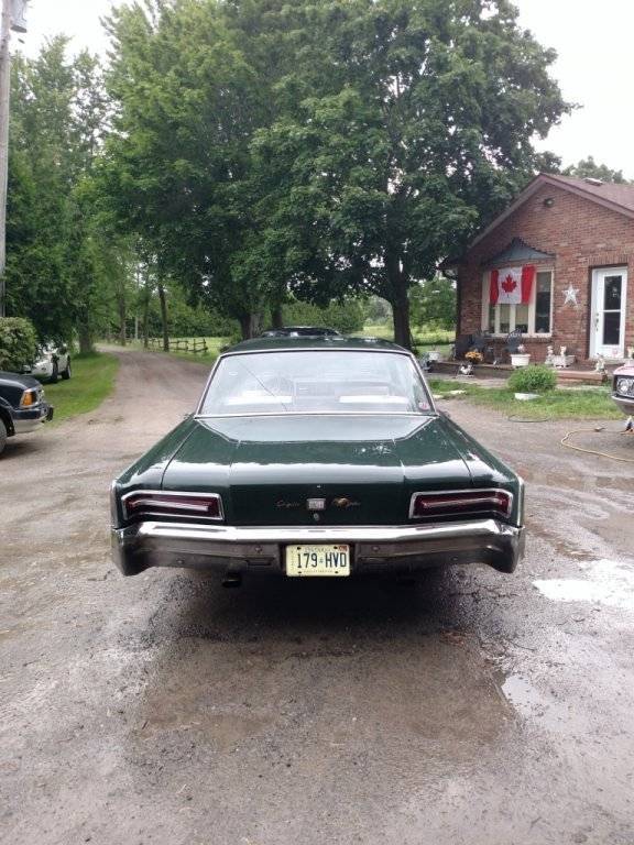

If you are using turn downs make them invisible like Wills (bluefury) if using tips go with 71 SF GT style if you can, if you want cheaper maybe some 68-70 Plymouth B body tips, but don't go with cheap chrome extensions at all :)
