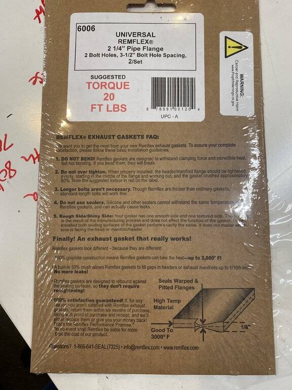

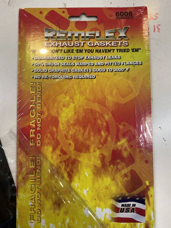

I ha found an expensive one (compared to the $2.00 parts store version). It bid double thickness. It requires a light torque and so far hasn’t burned through like the last two. I have the info somewhere I will find it.
Here it is. REMFLEX Graphite.
So far so good after 2,000 miles. My other ones didn’t last 1,000 miles before burning up.

I have use Remflex header gaskets on a couple of engines and they work great
I finally put these in last night. What a difference. I had no idea how much of an improvement these would be. I expected there was a bit of a leak, but oh my what a difference. It doesn't sound like the same car. I hope they lost well.
I have had my Remflex gaskets on now for about 4,000 miles with no issues including a couple of 6-8 hour runs with just shutting down for gas.
