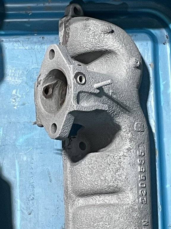

As shown in the picture the valve and all the parts are gone. Is tapping threads for plugs a good solution?
Those brass bushings will tap out of the cast iron casting. Might be a bit tedious to tap them for a plug?
Alternatively, you can knock the bushings out and put a 4” bolt with washers through the holes.
There were 2 short bolts, one on each side and I removed them thinking they hindered the exhaust flow. But now that I’m re-thinking that it must not matter because that rod, for the valve was in there anyways. Duh.
I was a little concerned the sleeves might twist out while tapping. I like that solution to fill the holes.

Slip plate is awsome. You have a few choices that I see. Tap and thread and plug, put a shouldered bot through it so the shoulder hists both bushings. Or take them out and have them welded closed which would be my last choice in case you want to put it back in. Cant be a easy to find manifold. Man your close to me.

You could use 'Carriage Head Bolts'? Insert from the Inside and then Lock Nut from the outside....
