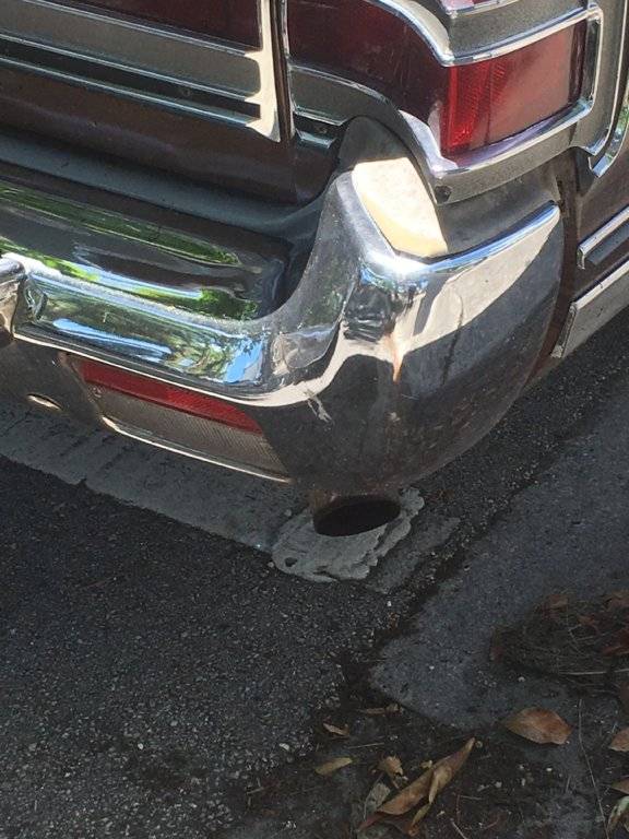

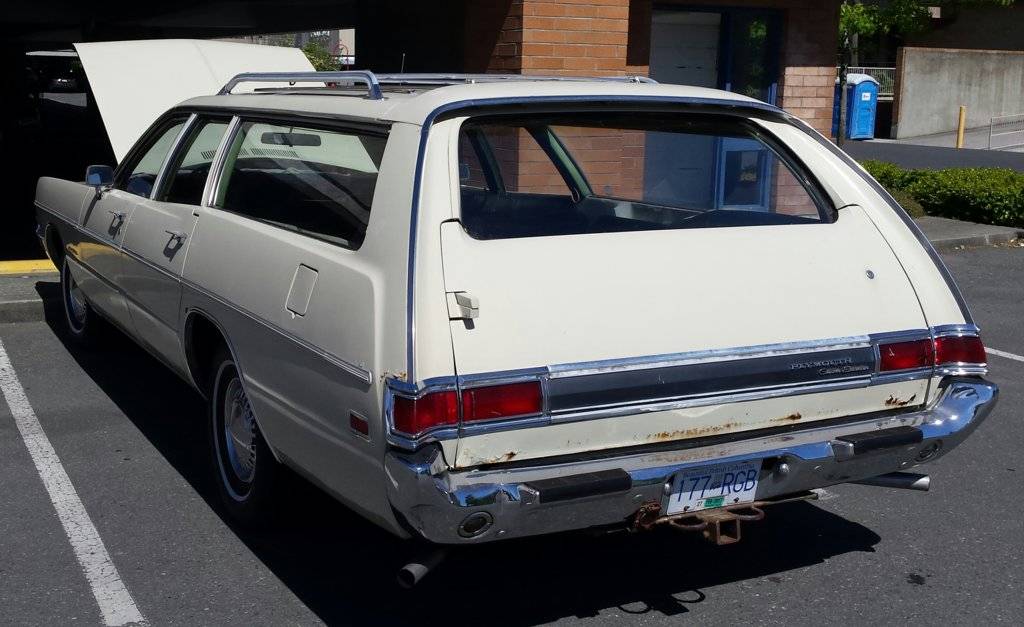

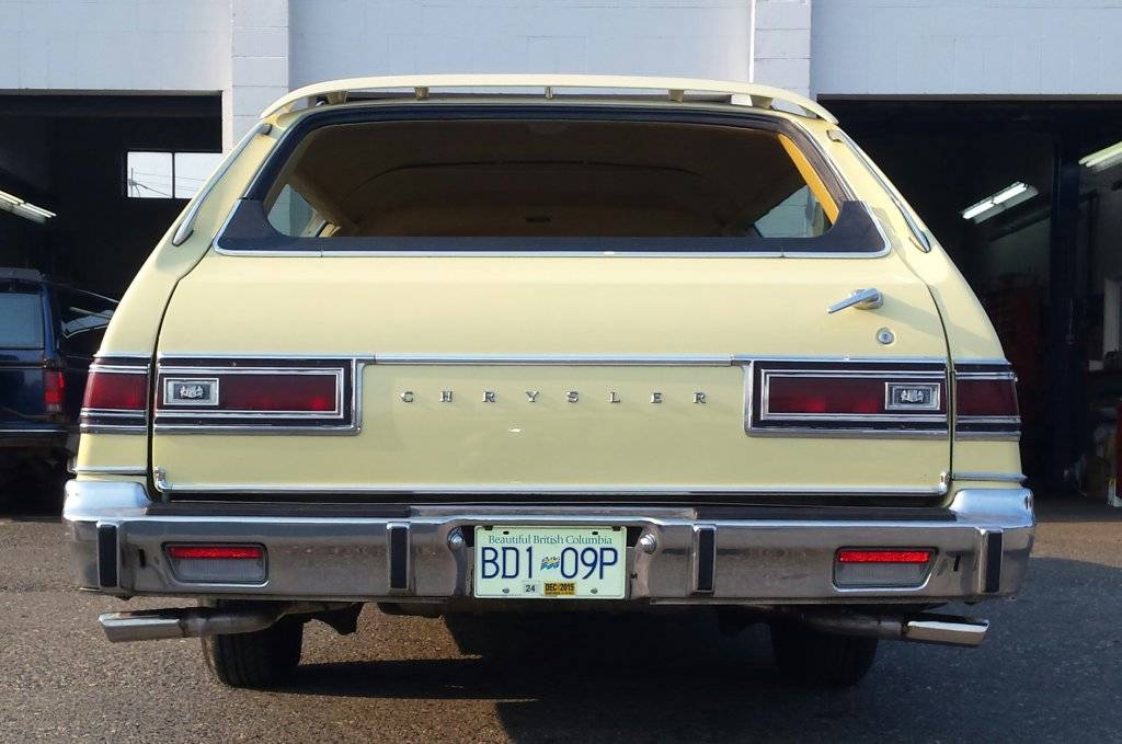

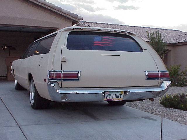

Here's a wagon with a TTi system. In my opinion, not the greatest look, especially for what they cost. I think the factory pipes exited right at the corner of the rear bumper where it meets the body, and they did have a slight turn down to them so that the pipe wasn't hanging down too low.

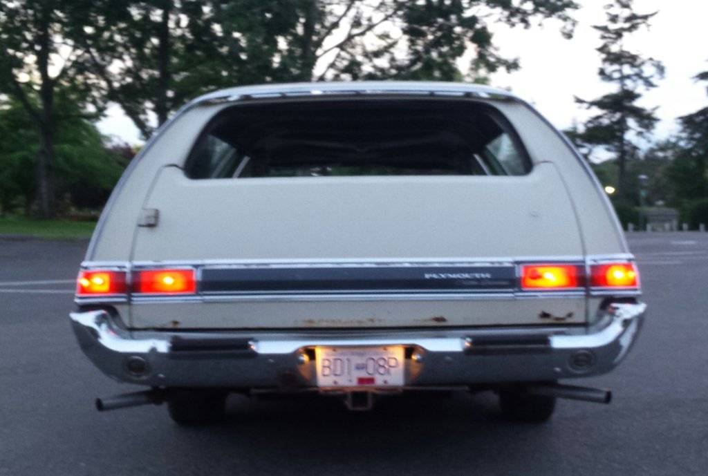

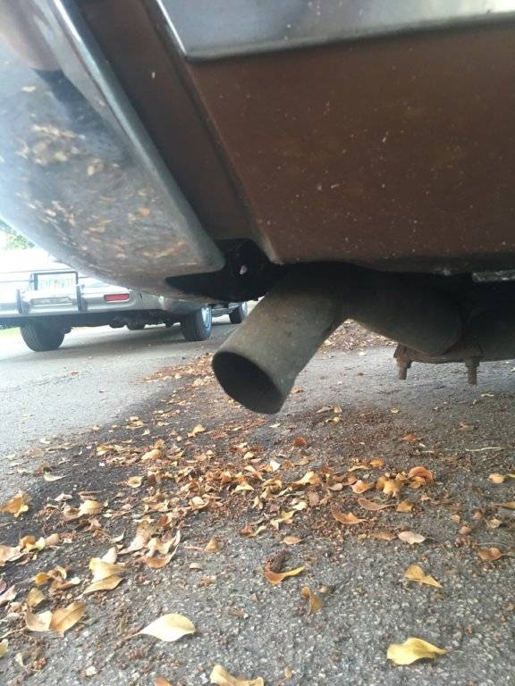

I have an NOS tailpipe for a fuselage wagon and it does not turn down. It should exit under the quarter panel. The tailpipes in this photo come out to far back IMHO and based on factory exhaust systems that I have had and seen.

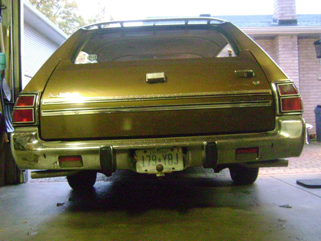

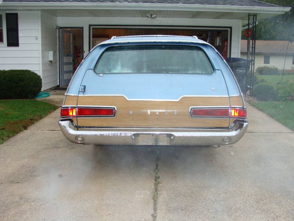

Here is mine with factory dual exhaust. Not original to my car but was taken off an original 71 Custom Suburban and swapped to mine many years ago.

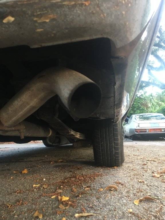

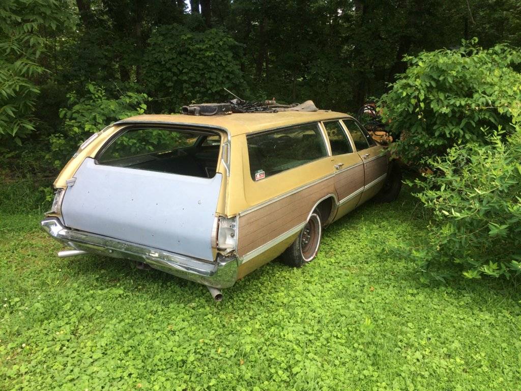

Here’s mine which I had copied exactly from the original when I had it replaced.

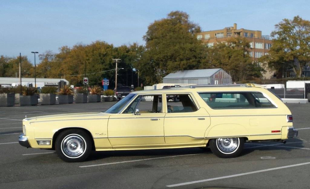

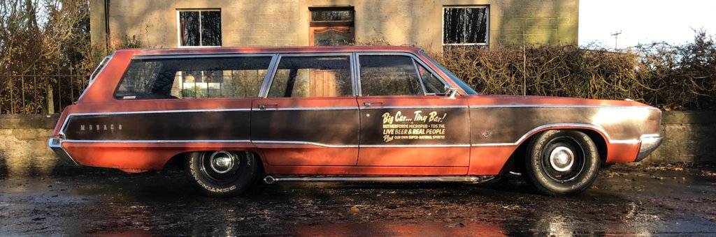

Marco's yellow '77 has great looking tips, and in the right spot.
