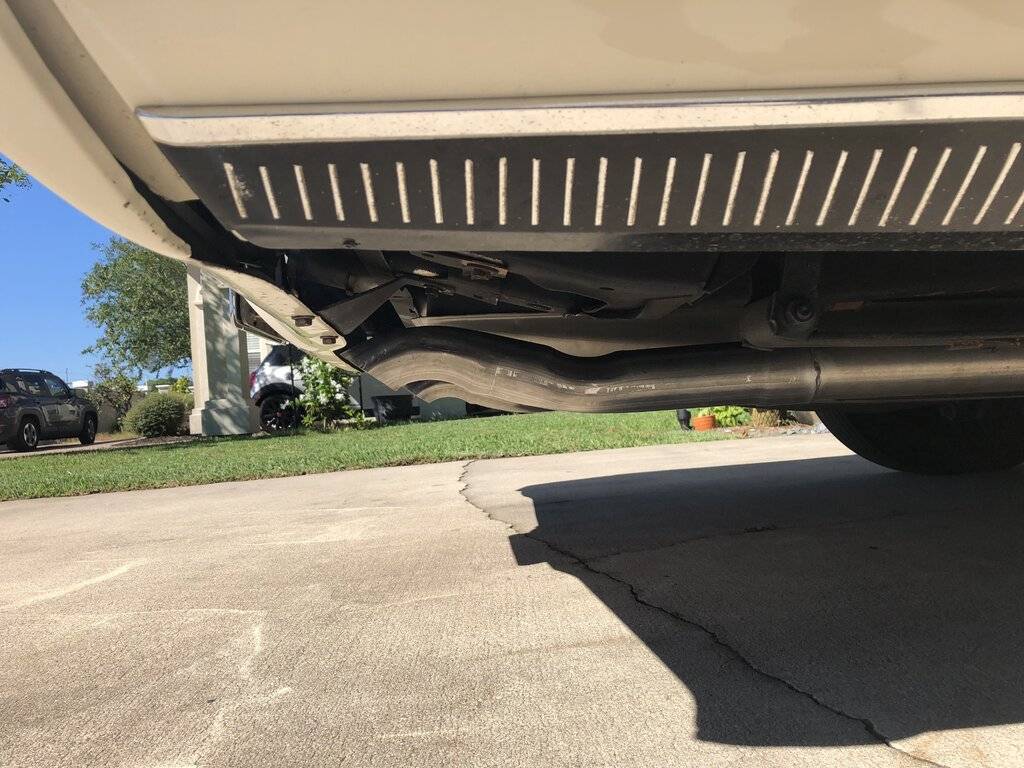

Ugly tips from previous owner.

Gone!

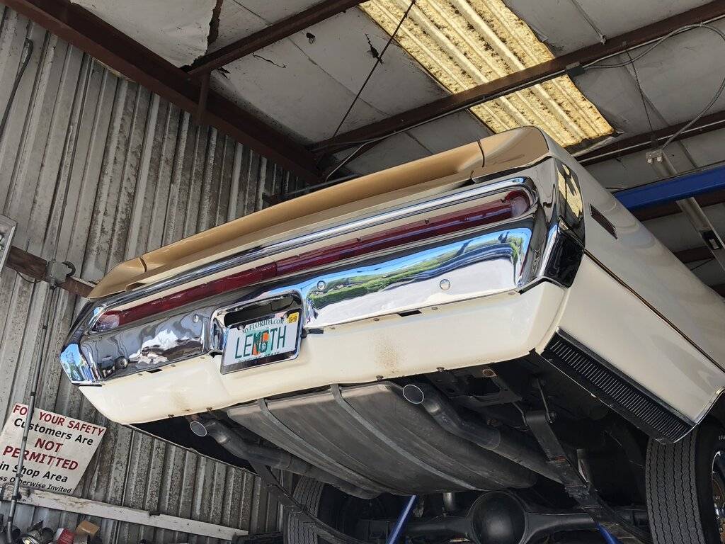

Made at the shop.

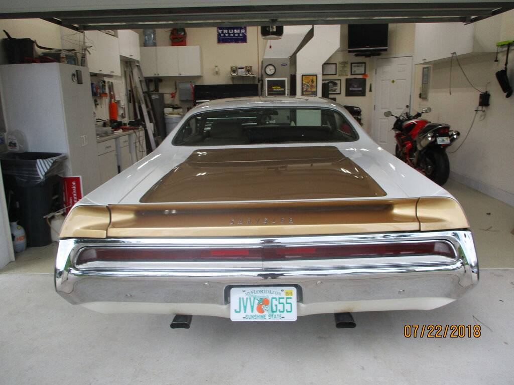

Proper Chrysler tips!
Those are nice!

Your tips along with Trace 300's photos should be good templates for a pipe bender.
