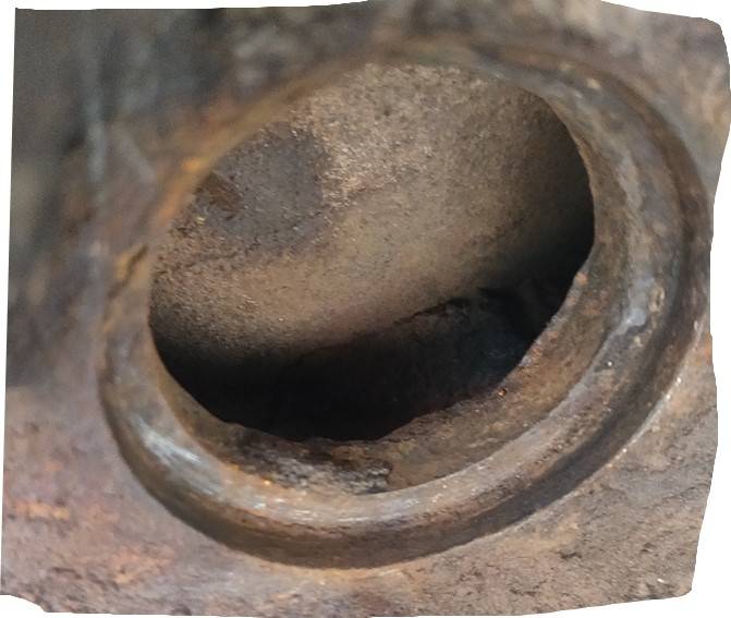

Also, I'm replacing the expansion plugs in the 326 engine from this car. The original expansion plugs measure 1.61 (assuming that is the same as a 1 5/8 plug) but seem to be a flat disk (see picture). I'm not sure where to get these from as my local Napa store wanted to sell me the standard plug with a thick edge. I did find a zinc plug at Grainger part number 5MTN7 which looks like it could be it but wanted to see if anyone else had any thoughts.

if you can measure correctly the original seal O.D. ,, the bore on the case where the seal installs and the I.D. of the seal (use the surface area of your pinion yoke where the seal runs ) i may be able to look up the seal number as i have a couple old CR seals cross reference books here . as far as the expansion plugs a modern O.D. equivalent of the original should fit.
