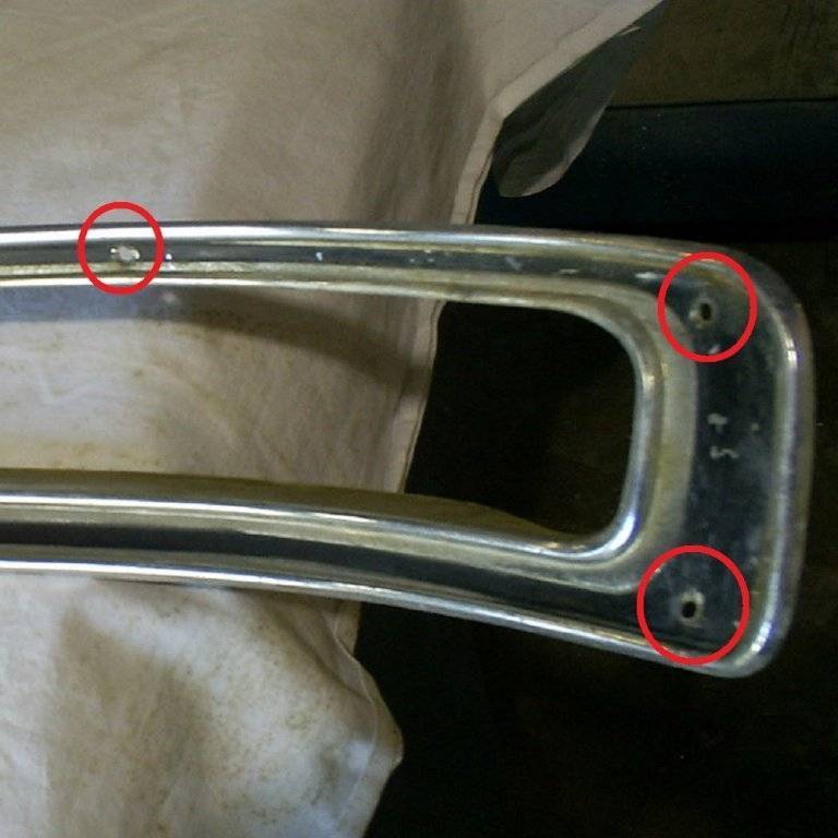

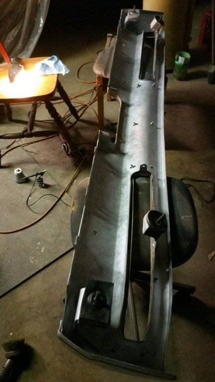

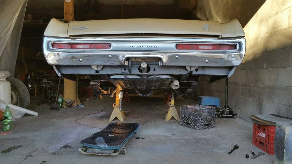

l justtttt had my 70 fury 3 rear bumper apart and it has the screw setup on the back with the tin nuts...am assuming its original to the car...
l first noticed the difference between mine and Bills...
had no idea their were different panels..w/wo the black and then theres the new 70 pic with the orange....
just trying to sort out whats what here or should be so if someones got a definitive awnser to all this would be nice...

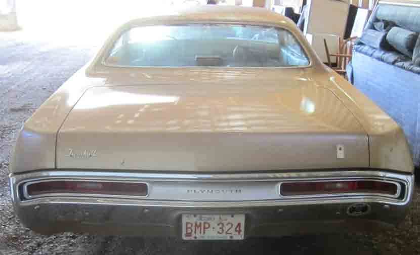

mine...70 FURY 3 with attached fasteners on backside...no black...black script
Bills/70 fury 3 with black...silver Plymouth script
Bill Furys GT l believe
thoughts....
