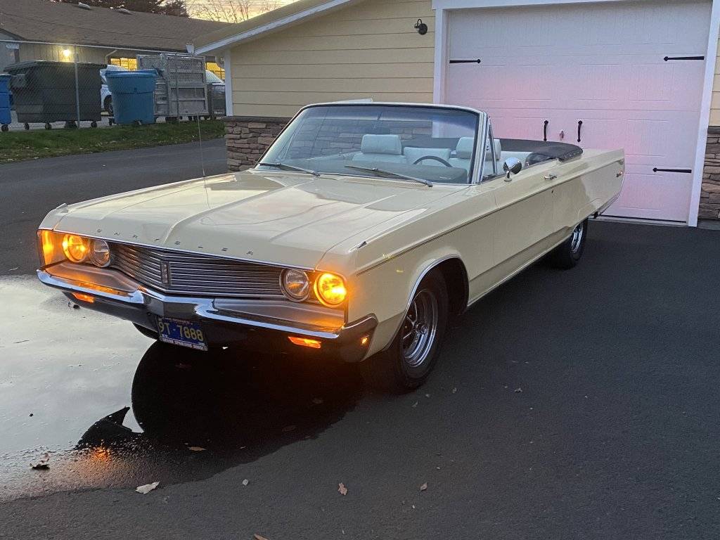

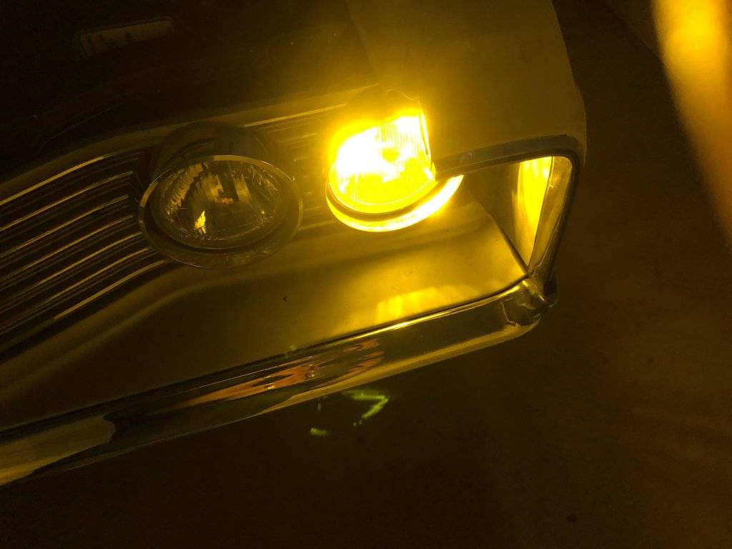

Hella Bi-Focal low beams with LED city light bulbs that I installed in the sockets they come with, and Hella H1 high beams with 100W lamps. Sourced the lights from Mr. Stern.
