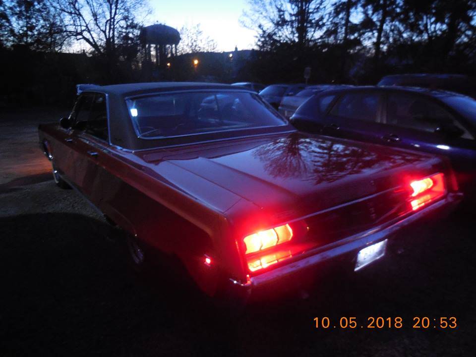

Finally got my 360 degree barrell LED bulbs from super brite Led for the 69 Fury aka Frankie.
Thanks to the pandemic the box sat at the border as it was closed and still is
Thankfully the Kinex place shipped it to me at a cost of course but long overdue.
So I wasted no time installing them.
The purpose of this upgrade is reducing the load on the electrical system.
Gone is the annoying lights dimming or flickering when hitting the brake or using the turn signal. Plus the ammeter gauge will not be dancing as much either.
Having brighter lights is a plus.

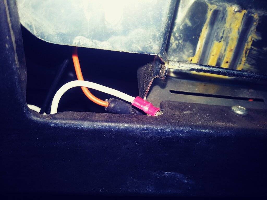

Simply reverse the spades in the flasher plug. Where black was is now red and vice versa.
cbarge
World Famous Barge in a Budget
Nov 22, 2010
5,098
8,426
Kingston Ontario Eh?
Attach the white ground wire to any metal surface. Typically an existing screw in the bottom of dash or ashtray..

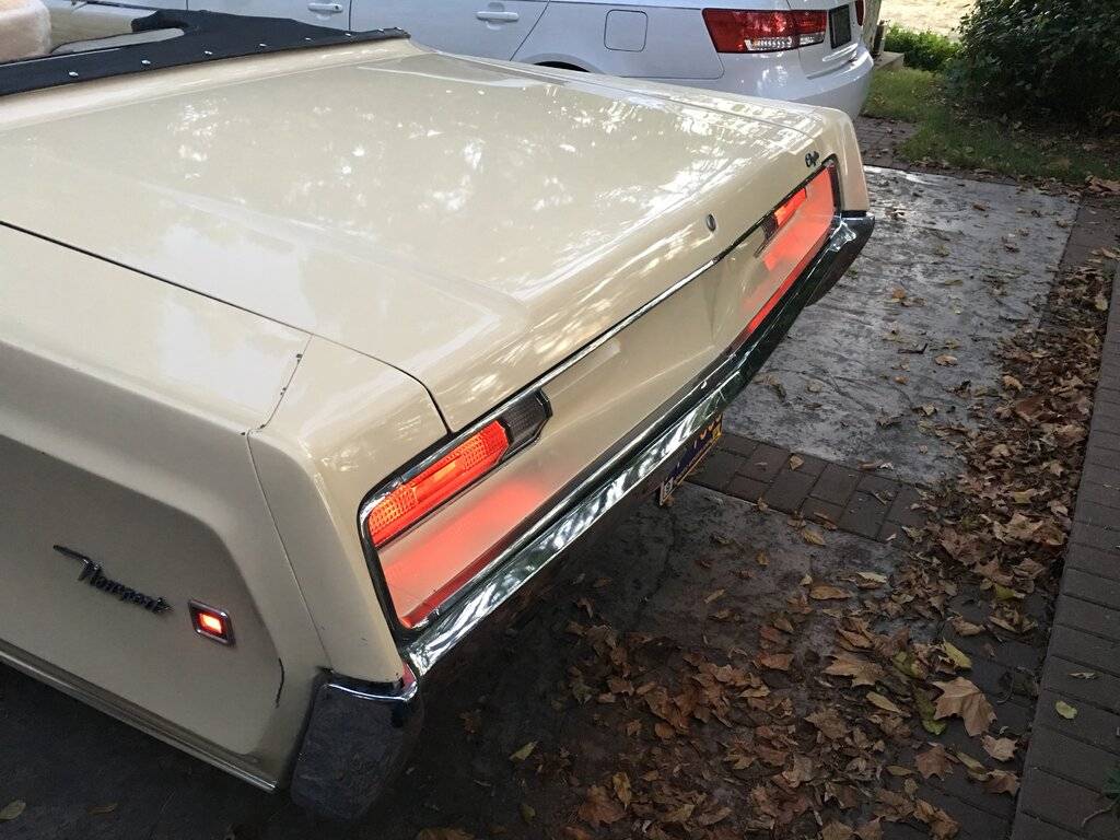

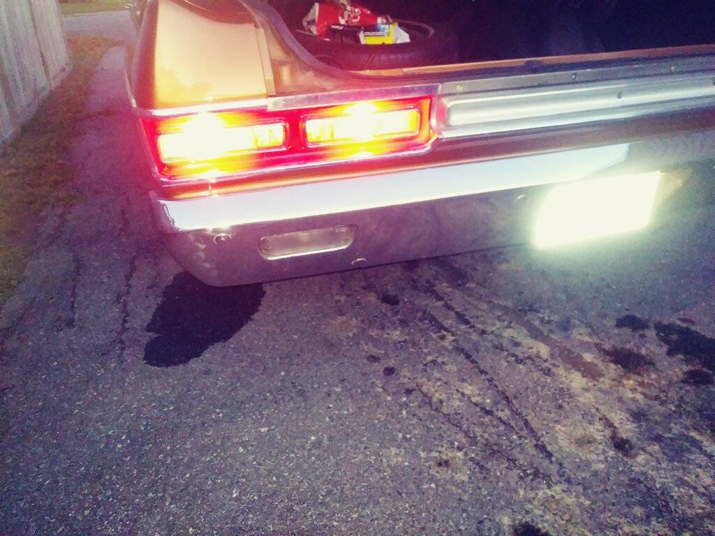

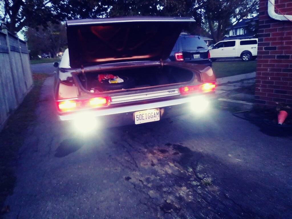

I shoulda taken before pics but the results speak for themselves..
I did cool white reverse lights so Maggie can see when parking the car at night.

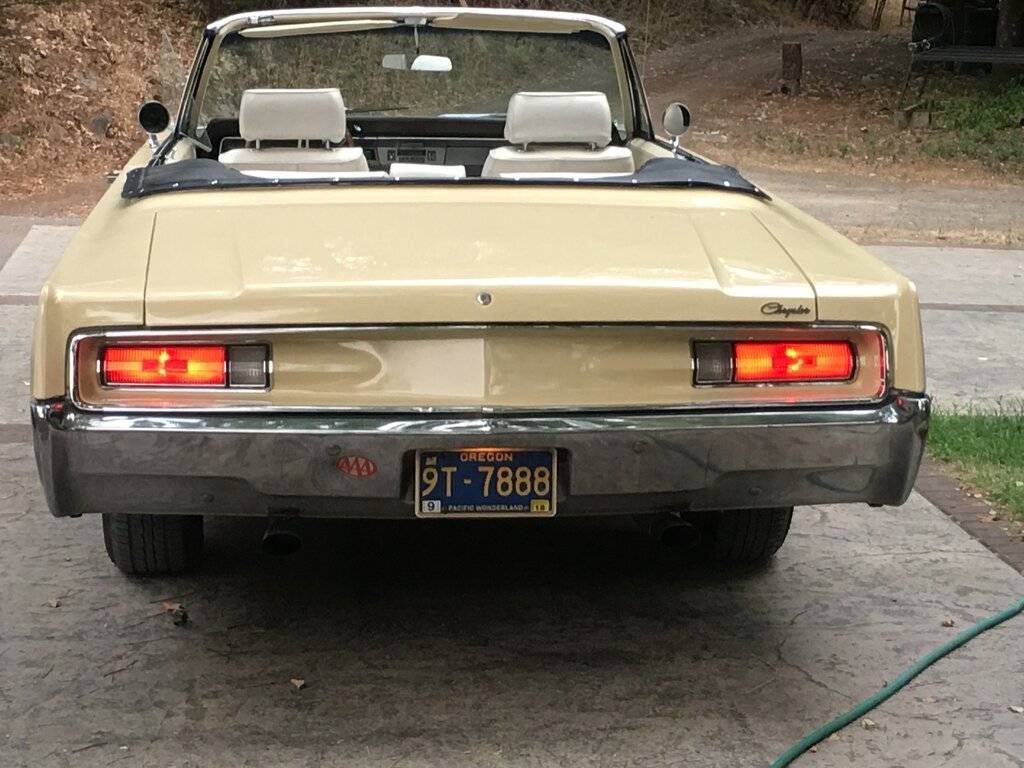

I tried a set a few years ago not knowing what to get. All the LED elements in the tail lights bulbs while bright but never hit the reflectors correctly [too few leds per bulb?] and the results were very poor and dim. I pulled them and put back the 360 degree radiation Edison bulbs. Since I also have a 69 Fury III I would love to know what you used or where to find out. Looks great.

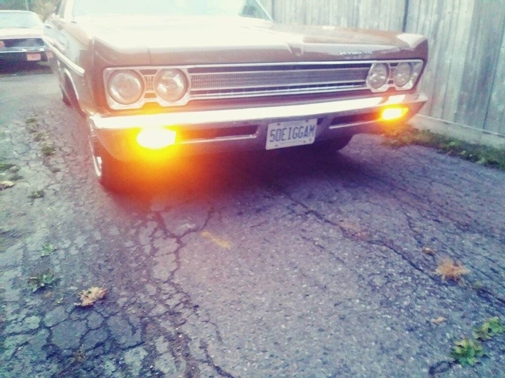

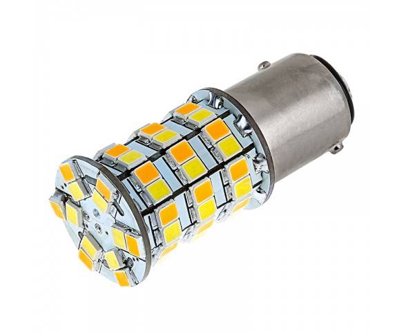

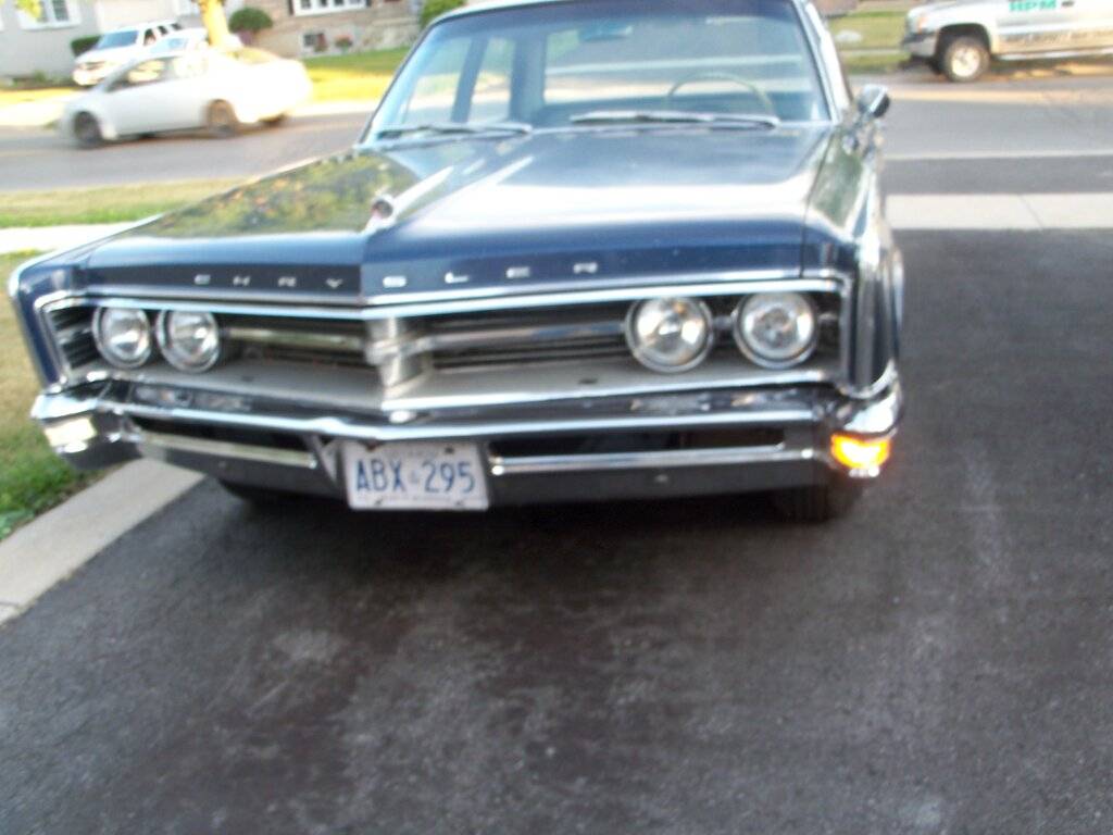

For cars with clear front turn sgnal lenses and amber bulbs,I use the "switchback" LED 360 barrel bulbs.
With park lights on they are bright enough to be daytime running lights...
Hit the turn signal and the color switches to amber!!
PARK...
WITH LEFT SIGNAL ON...AMBER
1157 Switchback LED Bulb - Dual Function 60 SMD LED Tower - A Type - BAY15D Bulb | Super Bright LEDs

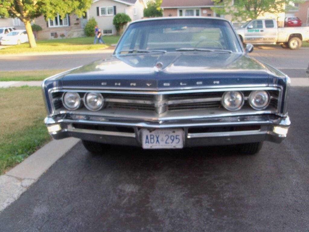

In my experience these colour-changing "switchback" bulbs are the only LED bulbs that will work for the front turn signals in a 66 Chrysler. The regular ones that are amber all the time did not work properly. Electrically they need to behave like two separate filaments for running lights and turn signals. The colour-changing ones do, but the regular amber ones I got did not, so the power would feedback through the circuit and cause unintended operation.
