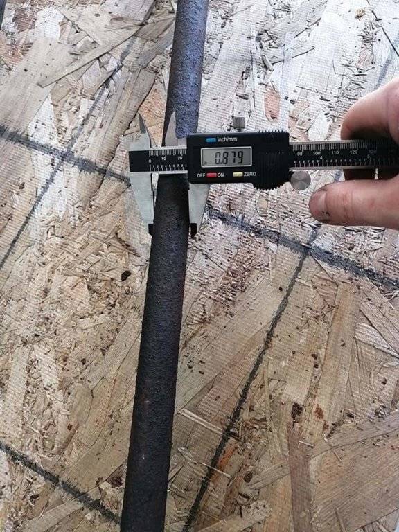

I measured the front sway bar on my '65 Chrysler with a digital caliper = .875 or 7/8".

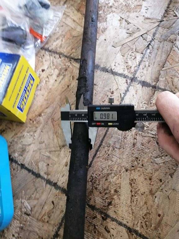

Sorry Dave there was actually two sizes used on C Bodies...
7/8, and the thicker 15/16

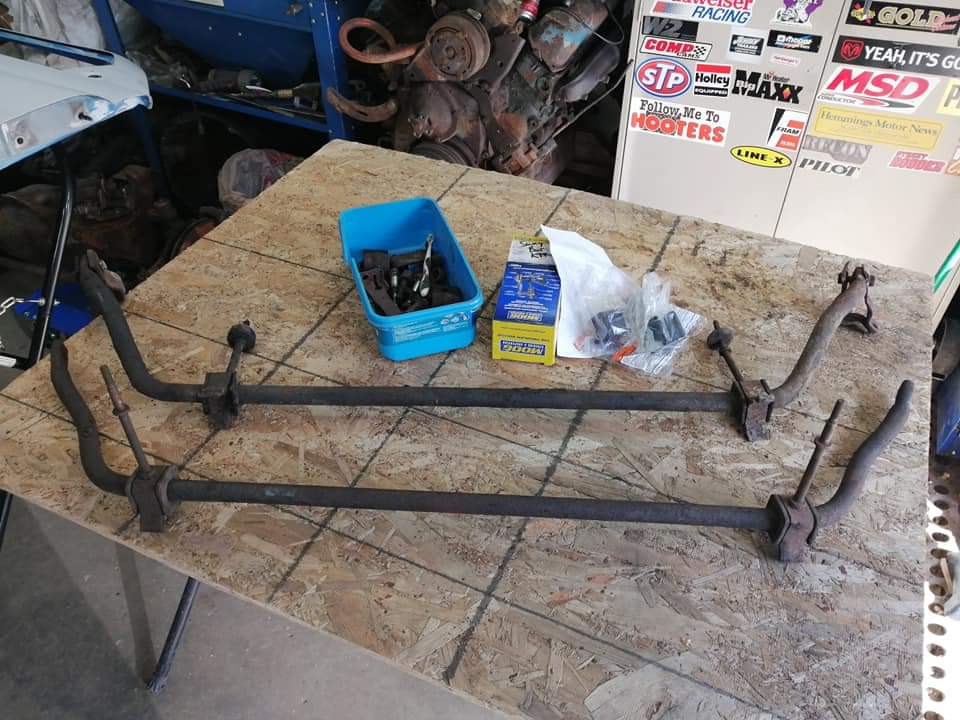

Mine is the 15/16. Has to be. None of the 7/8" replacement links fit the bar safely. Meaning the bushing gets completely distorted. I did the MOOG OEM fix on one, and cut it open. Was a total PIA, but it worked.
Mine looks like the lower one of the two you posted.
