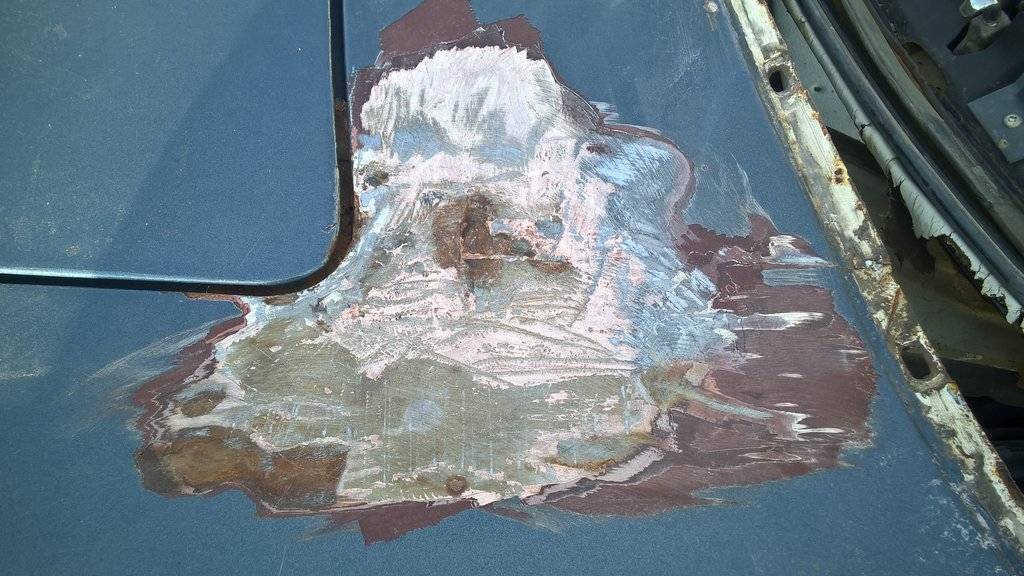

Does anybody know what alloy of lead the factory used? Period correct (1970), auto body use type would be appreciated also. I am pretty much limited to pure lead or 50/50 lead/tin. The latter of which I would prefer to use. I am cleaning up the dutchmans panel on my 1970 Newport convertible which was leaded (hastily) at the factory, then bondoed. I just want whatever I put on to get along with whatever they put on. I am also wondering if flux was used?

Thanks Big_John, I didn't know they offered that. I am not expecting a perfect "no bondo" finish. Simply looking to seal the base with real metal, then a skim of "all metal", followed by bondo. This could have been avoided had the factory guy been more liberal in the application of lead, in the photo I posted you can make our the "T" intersection where the dutchman meets the quarter and trunk rail. This is where moisture was able to compromise the talc in the bondo. I am trying to avoid that in another 47 years.
