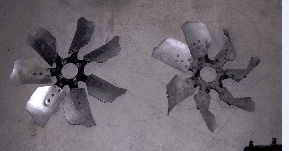

I guess 66 is different, here is my 69
Alan

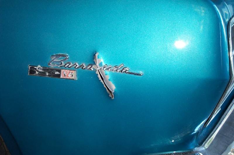

Another local guy had a flex fan come apart while timing his car. Killed him on the spot.
Stuff like that that keeps me checking on things regularly. Even and esp seemingly mundane things.
This broken fan from that point made me look twice at every used part especially those that were repaired or rusty.
When working on my car are watching someone else I always stay clear of the fan alignment plane, I would never use a fan that had ANY repair work, twisted blade, welding, etc.
