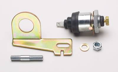

    I'd like to experiment (?) with a fast idle solenoid to see how that reduces or eliminates the trembling my 400 motor (with an Edelbrock 1406 carb) demonstrates at idle with the A/C on. I have a 77 Newport.
    The trembling is just enough to be annoying and noticeable. This girl deserves better. There is no trembling without the A/C. I have the original compressor and don't want to spend the big bucks to replace it. The AC--converted to R-134A--works well, although it doesn't get super cold. Around 58F.
    Can someone help me research the correct part number from Summit? Do I need a special bracket? I want to connect the solenoid so that it only steps up the idle with the AC on. And not by much.
    Thanks Everyone!

    Check out Summit they have a line of them.
  3. rkrochen
    rkrochen Well-Known Member
    Messages:
    569
    Likes Received:
    373
    Joined:
    Jun 29, 2015
    Location:
    Teulon, Manitoba
    This is for the 8059 carb. Not sure if the bracket is correct but they should be able to help you. It will help.

    The solenoid was not cheap, like about $150. But it has made a big difference in how she idles with the a/c on. I was afraid that she would idle too high, but no, she just purrs at all times now. I'm a happy camper.

    That’s great news I was pretty sure it would. Where did you take the power from.
  9. Pclancy
    Pclancy Active Member FCBO Gold Member
    Messages:
    229
    Likes Received:
    88
    Joined:
    Mar 27, 2016
    Location:
    Washington, DC
    From the A/C clutch.
