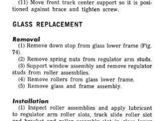

Best place I can think to put this since the quarter glass falls under the body section in the FSM.
Anyone have any tips on removing the quarter glass? I've got the spring clips off and the rollers out. But at this stage the FSM just says remove the glass. But er ummm the thing is still attached to the tracks via the track rollers. What steps are missed in the FSM?
Screenshot from 2014-10-12 08:56:08.jpg
I can move it up and down and rotate slightly at will the regulator arms are all the way at the bottom of its movement. What I can't do is get it off the tracks. It doesn't seem to have enough rotation to spin the rear guide off the track and not enough movement forward to disengage the front rollers since the window frame hits the body. So I'm stuck.
