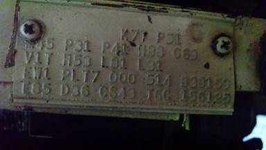

Ah. Now it all makes sense. Just for the curious, here are the fender and door tags
