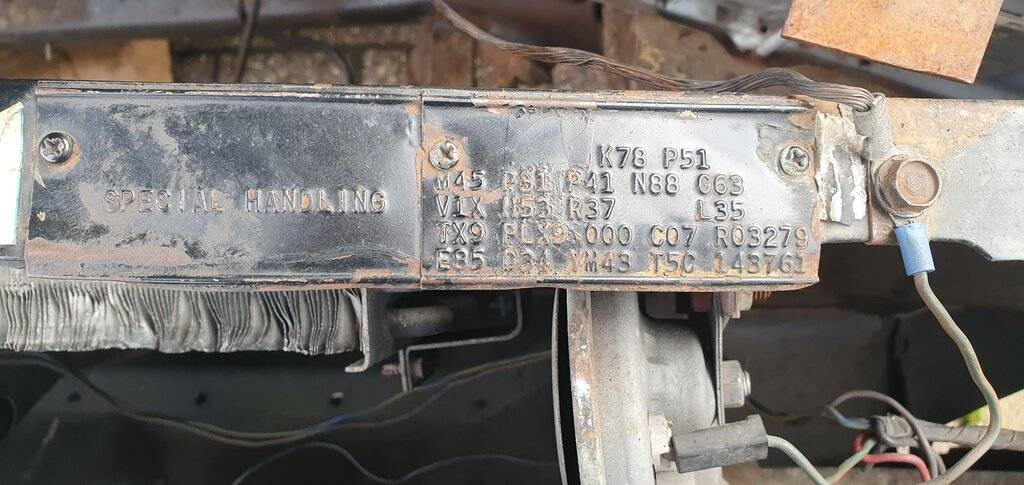

Hi all,
While waiting for some parts I would like to find out more about my '75 Imperial. Specifically, if the fender tag mentions anything about the brakes because mine is fitted with drum brakes in the rear. Pretty sure these came with disc brakes all around but the drums look the same age as the rest.
I find it hard to believe a PO would switch the discs for drums on a 5000+ lbs car

Should be 4 wheel discs from what I can tell. There are others know here that no much more about Imperials.
Bottom row -
E85 - 440-cid V8, 4-bbl carb
D34 - Automatic transmission - Torqueflite
VIN - YM23 T5C 143761
Y - Car Line - Imperial
M - Series - LeBaron
23 - 2dr Hardtop
T - Engine - 440-cid V8, 1-4bbl carb
5 - Model Year - 1975
C - Assembly plant - East Jefferson Avenue
143761 - Serial Number - Starting at 100000
Second row -
TX9 - Body Colour - Formal Black
PLX9 - Interior trim -
P - Premium
L - Leather & Vinyl, recline
X9 - Black
000 - Interior Colour -
C07 R03278 - SPD Dec 07? Not sure what the R in the serial number represents.
No. There won't be anything coded regarding brakes on the tag.

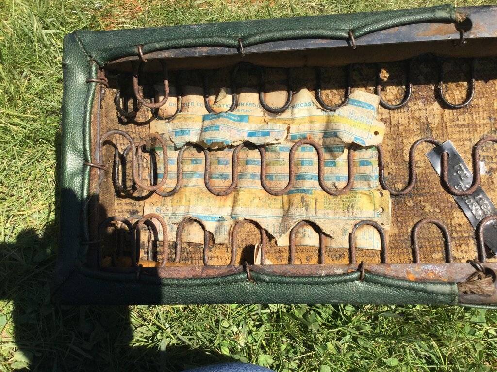

Finding a broadcast sheet will give us insight into the R VON.
Need to find the build sheet! There might be a hand-written note on it about "Special Handling"? AND which brake system it was produced with.

Under the rear seats seem to be the most usual location, although there are others in the seats, too. Stuffed under the springs, which can cause some issues with extraction in one piece. Possibly a hi-res picture might be an option?
That "special handling car" tag is interesting, that's usually on police cars.
SPECIAL HANDLING tags are found on police cars but can be found on other applications too. Cars destined as promo, show or one time special purpose (think parade, sweepstakes, event sponsor transport) can have them.
I think decoding the R VON will tell us why the car has the Special Handling tag.
What are the usual places for the build sheet? Under the front seats?
The most common place is in the front seat bottom or seat back or under the springs in the back seat or the rear upright seat. Finding the sheet will help us answer the question about brakes.
Some plants will leave them taped to back of the dash.
Under carpet.
Above headliners.
The most unusual place I've ever seen a broadcast is one shoved into the buddy seat.

special handling means it was ordered. nothing to do with the steering, suspension or brakes

Sorry, I screwed up the VIN Decode somehow. I had YM23 but it's YM43. I'd love to see some pics. I'm guessing this was a promotional car, a triple black Imperial, you don't get any classier then that IMO.
R VON means it was a Public Relations car. Special Handling meant the car was build with special care, only put the best pieces on this car.
