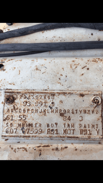

Im trying to get my tag decoded.
I figured out everything under the letters.
Can someone help me with the number codes.
This is a 65 fury, first sold as a police car.
Under the 3 is a 9 which means variable wipers, the rest I can’t find.
Thanks!!
AB 61 383 4bbl 330hp
D 5 Automatic transmission
E 5 Heater w/ Defrost
Q 8 Radio Suppressor Package
B P Plymouth
D 9 Police
Y 1 2 Dr. Sedan
T K Police (Bench)
R 8 Vinyl + Cloth seats
M T Tan
P W White roof
A W White
I 1 monotone
N
T Y Medium Tan Met. Upper door frames
I didn't find anything on the upper most number combos.
Thanks, I appreciate the help. I have all the letters figured out.
The numbers are what I can’t figure out.
There’s a lot of 9s.
Seems the 9 in the vin number means police, also the 9 under the D means police as well.
That’s the first I’ve seen a panel clip used to hold a fender tag. @69CoronetRT
