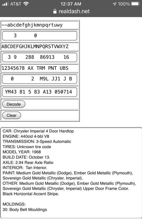

I used to have the books on decoding the mopar fender build tags but I cant find them & the stuff I find online doesn't seem to work very good for a 68 can anyone help me with this
everything on there makes sense with the exception of two options which are
R4 you had R1 on the decoder and the interior color as far as I know the car is mostly un molested it has black interior & the Antique Gold & black seats. So if someone has changed the interior color they did a very good job as everything in the interior looks to me to be factory

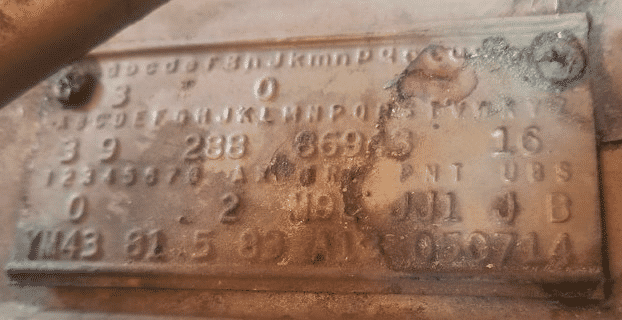

Sorry, I had a hard time guessing on what values were in which location due to the rust and blemishes on the tag.
Most of the decoders are close but not accurate for C-bodies let alone an Imperial. Need to find an interior dealer book to see the different stock seat selections

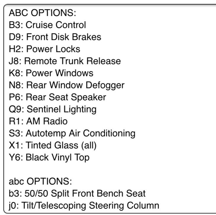

you typed everything correctly expect the R4 code which I believe is for the radio but the one that really confuses me is the interior color as you typed everything else correct as far as I can tell. Is the M9L code the interior color?
I think the interior code is M9E. I don’t see a M9L in the interior codes for 68 Imperial.

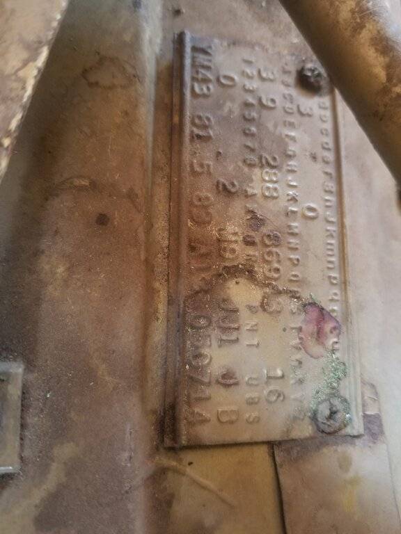

I may be M9E I'll have to look at it closer when I get home in the pic it looks like M9L but the pic of the tag isn't very good
If you zoom into the vertical picture I think I see the middle leg of the E. In the manual there is no L option.

it definitely has M9E interior installed I'll double check the tag when I can see it in person does anyone know what R4 option is when I put it in the decoder it says unknown option
R4 is am search tune with the button on the floor to switch from signal to signal.
