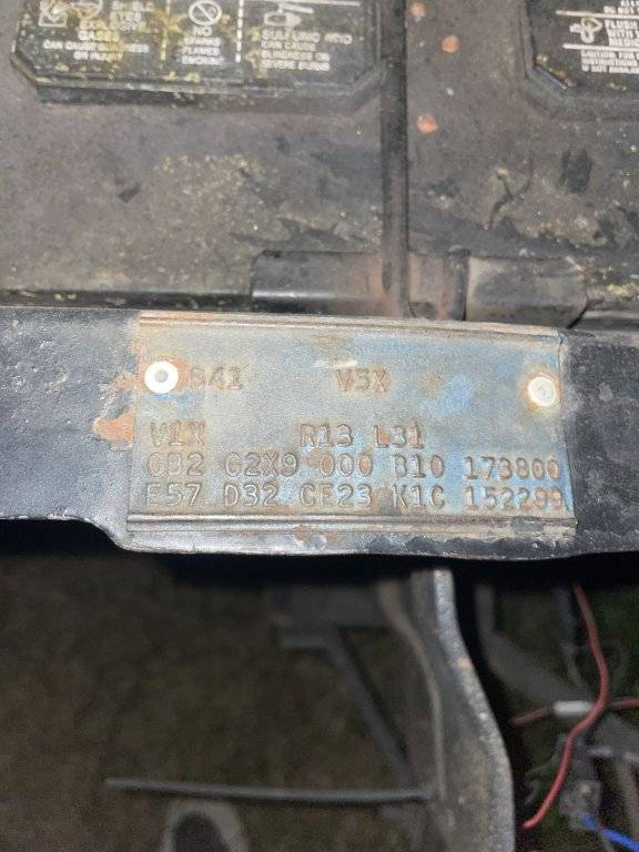

Please help me decode this tag I know gb2 is the color code but what does everything else mean?
detmatt
Nov 14, 2010
26,901
24,062
B41 is front disc brakes
V5X is black body side moldings
V1X is black vinyl roof
R13 is high powered AM radio
L31 is hood or fender turn signals
GB2 is Glacial blue metallic
G2X9 Not sure about the G but 2 is vinyl bench and X9 is black
B10 is Tuesday November 10th
E57 is 360 2bbl
D32 is 727 auto trans
2 door hardtop Chrysler.

I had found most of them but thank you some of those I still couldn’t find out about, so your saying my car was built November 10th and I’m guessing in the year 1970 as 71 production would turn into 72 production by September of 71 correct

Let me complete the info helpfully posted by @detmatt earlier today and fully decode CE23K1C152299's fender tag:
C: Chrysler
E: Economy (Newport Royal -- E was used for Newports till the Royals came along, see here for more info)
23: 2-Door Hardtop
K: 360 cid 2-barrel V8
1: 1971 (Model Year)
C: Jefferson Avenue, MI, USA
152299: Sequence number
E57: 360 cid 2-barrel V8
D32: Automatic Transmission
GB2: Glacial Blue Exterior Color
G2X9: Trim - Low, Vinyl Bench Seats, Black (the reason why Matt could not find a link to that trim on the helpful Hamtramck Library is that the Royal is a late addition to the 1971 Newport lineup, and the G trim is special to the Newport Royal -- see here for details and links to photos of what G1 and G2 trims look like)
000: Full Door Frames
B10: Build Date = November 10, 1970 (Edit: Scheduled build date, as noted by @69CoronetRT )
173800: Order number
R13: Deluxe AM Radio (5 1/2 Watts)
L31: Hood/Fender Mounted Turn Signals (in the case of a Royal, the repeaters are on the fender tops)
V1X: Full Vinyl Top, Black
B41: Power Front Disc Brakes
V5Y: Body Side Molding Inserts, Black

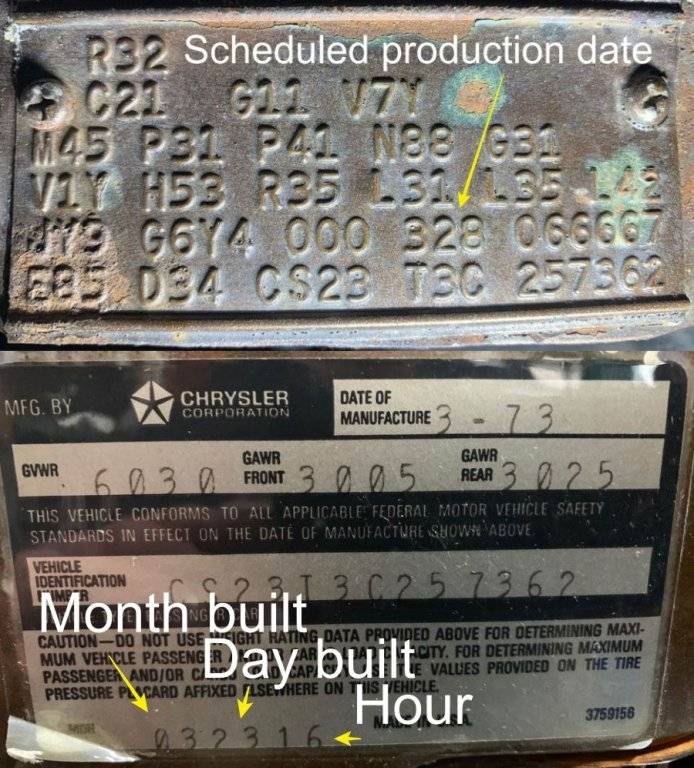

All the fender tag tells us is the car was SCHEDULED for November 10th. There is nothing present to show what day the car was actually built. The car could have been built days or weeks before or after that date.

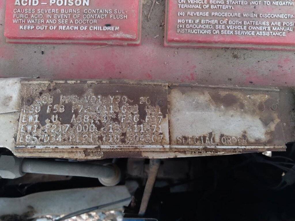

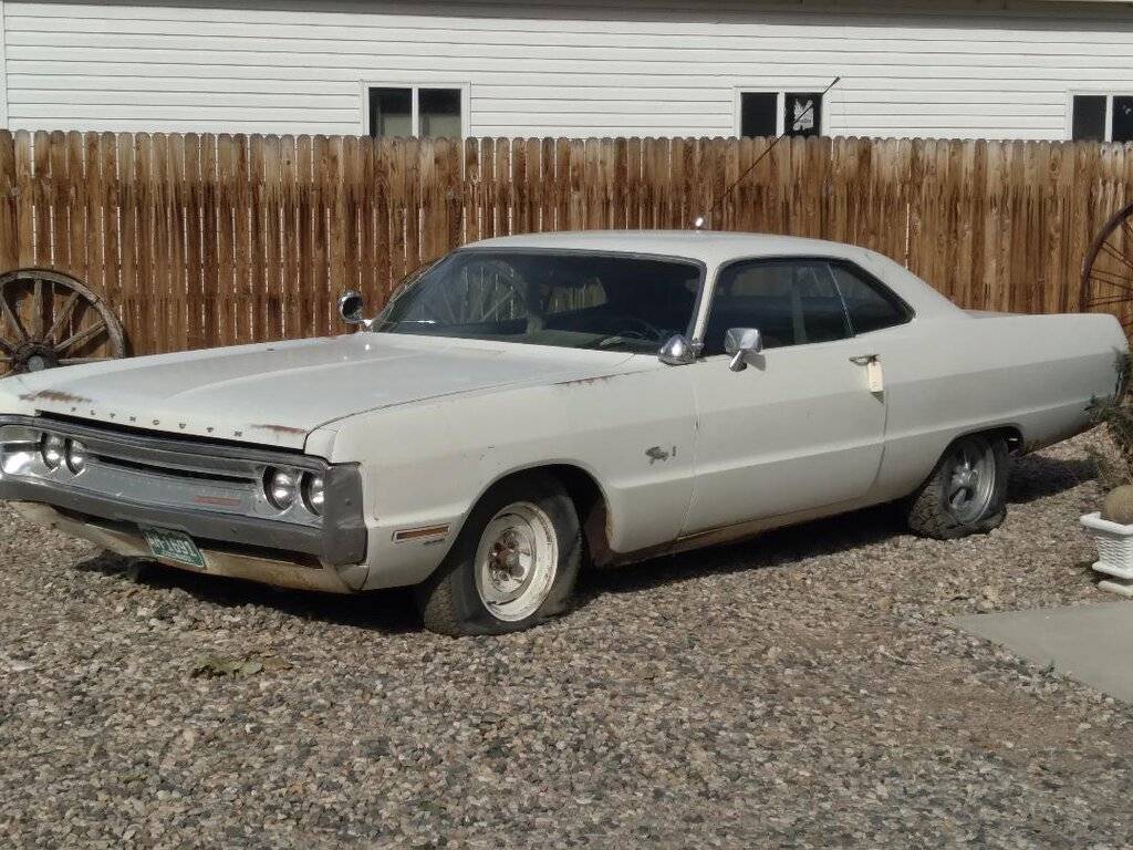

That sure calls for some rethinking! Your example is a police car. How does it look on the inside?
PeugFra
Jul 11, 2018
920
628
Italy

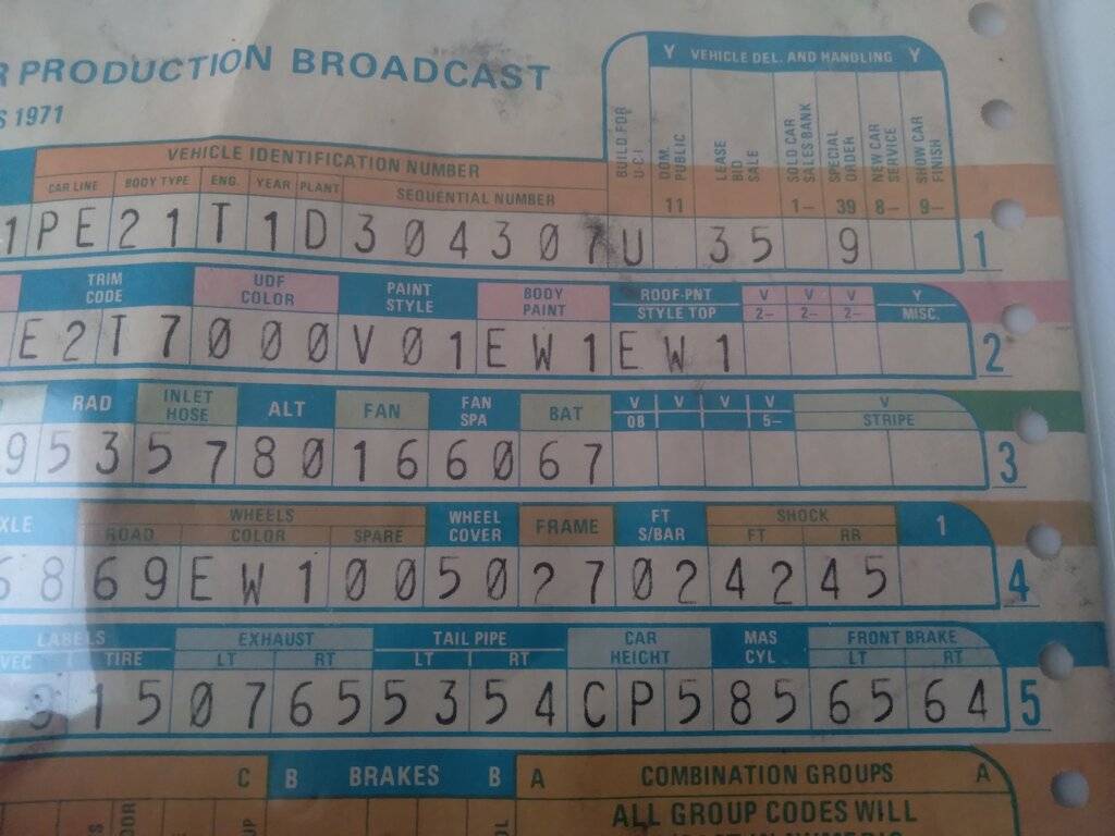

That's a very interesting lead! Here are some pictures from that thread:
There are also some thoughts in that thread about body style code 21 vs. 23:
It won't have rear window cranks because it is a coupe not a hardtop.
The "21" in the VIN indicates it.
Carsten
Ahhh,makes sense. I have had a couple 23 b bodies, and older sedans with obvious b pillars. From looking at it, I called it a hard top. I guess I assumed a couple would have more of a pillar. Dang, didnt even pay attention the 21 staring me in the face. I knew that. Thanks
Apart from the thin B pillar also the missing window frames make above car look like a hardtop. You can also see the full-height door panels. The "000" code on the fender tag comes from the UDF Color slot in Line 2 on the broadcast sheet. So it says something about color, in this case about its absence, because there is nowhere to put it.

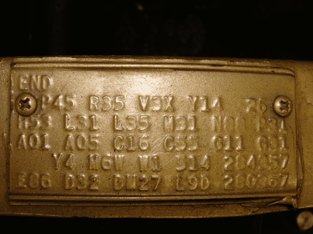

I have only been at the convertible thing for a little bit but have seen a similar thing on the tags
On the 69 tags there are paint codes for the body, the roof and the interior (not sure what gets this paint).
Here is my tag, it has both the body code and the roof code, typical of most cars painted one color.
Then there is Martin's tag, it only has the body code
I agree that the 000 is probably a null code for the interior paint as that is the position of the code on the tag and interior paint wasn't needed.
