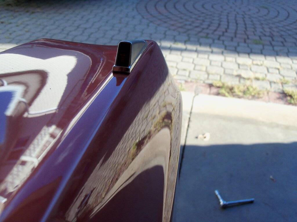

Any idea how to change the bulb on these?
The orange lense is screwed into the fixture.
Use your thumb to turn it. Or gently use on the edge of the lence a flat head screwdriver. (68/69 bullets had slots in them btw)
Once unscrewed the bulb is sandwiched between the socket and lense.

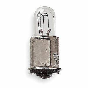

it is an aircraft type of bulb GE330 or part number 330
Your style of fender mount signals are very expensive to replace so be carefull with them,LOL
GE 330 - 1w/14v T1.75 Low Voltage Miniature Automotive Bulb

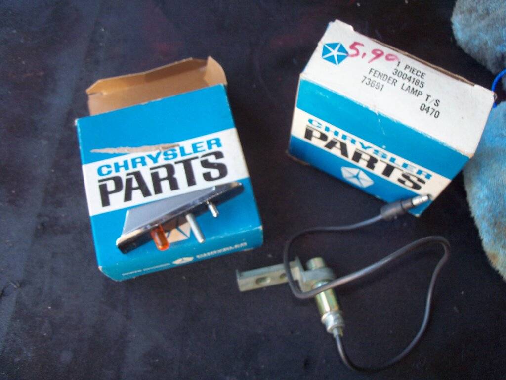

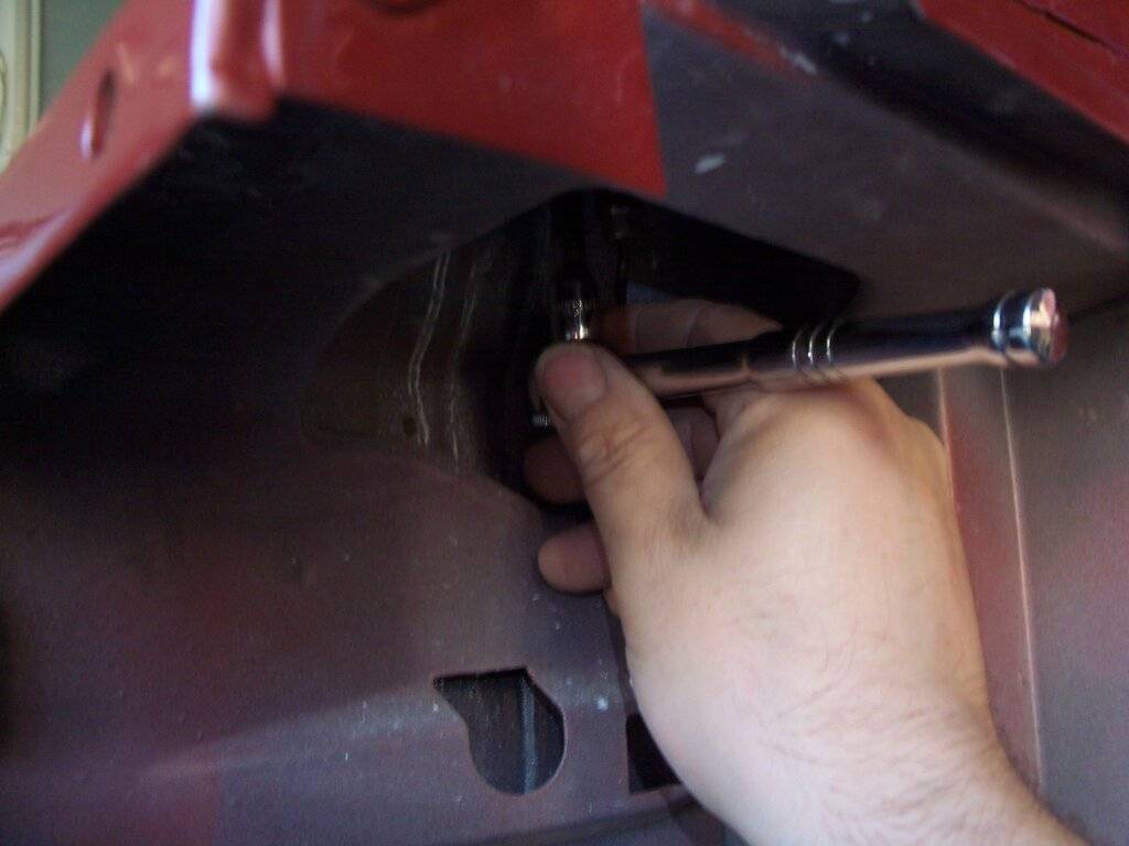

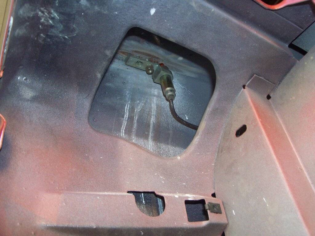

The socket slides into the assembly. Shown here with grille removed for clarity.
But most of the 50+ year old sockets are rusted together so removing the whole thing from the car may be necessary.
You have to be flexible like a chinese gymnast circus act to get to the inside the fender with the grille still attached--it can be done however without removing the grille--just need small hands and a 1/4 inch ratchet.
The driver side requires removing the washer jug,and passenger side may have to remove the horns to make room.
Yes,they are NOS..No you cannot have them--they are on the car,LOL!!!

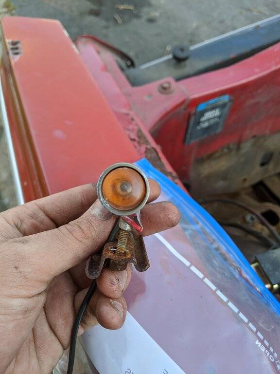

I also added a ground wire off the mounting stud. Had some grounding issues without it.
