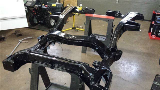

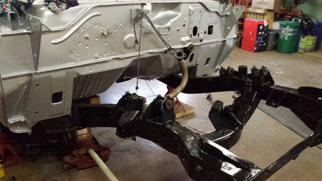

I purchased a stub frame and had it sand blasted, epoxy primed and painted with an epoxy in black. I plan on building the suspension, brakes, engine and transmission on this frame and then doing a complete swap with everything already in place. I have done this in lots of K frame cars and it works really well.
I plan on new torsion bars, sway bar and steering box from Firmfeel. I plan on using the 11.75 rotors for now but with 4 piston calipers.

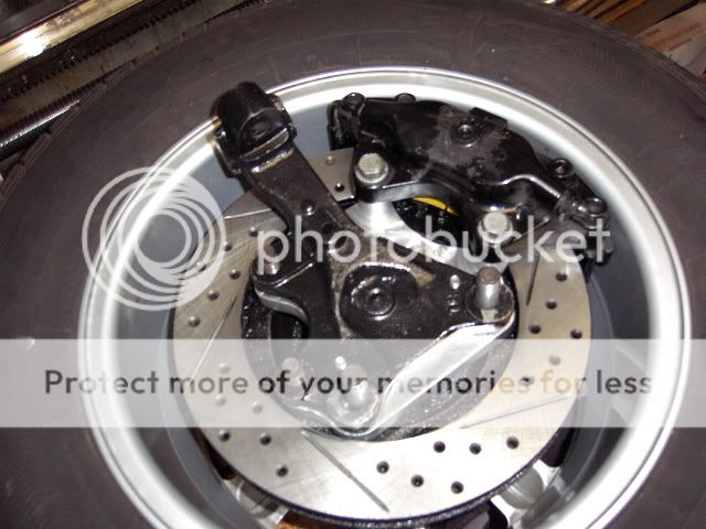

I intend to do something LIKE this, http://www.doctordiff.com/viper-caliper-mounting-brackets-for-mopar-drum-knuckles.html
not this particular one. There are some technical drawings/ prints floating around on the internet that I believe can be modified easily to fit a "C" body. You are aware that the '73 C body spindles in in demand for a performance build for B and E bodies and I believe that I read a thread on ProTouring Mopars that addresses the build of a caliper bracket to accommodate the 4 piston calipers.
I found the link: http://www.protouringmopar.com/show...-Body-spindles-on-a-E-Body&highlight=brads+70
If he can make it work for his E body it should be easy to do it for a C body.

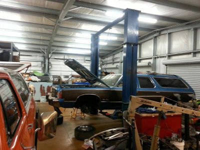

Another Stub frame project! keep us posted!View attachment 48320View attachment 48321
Looks great. How long have you been working on it?
I found someone locally that blasted and painted mine for $200
If I had to sand and wheel all that off it would have taken forever.
I still need to go back and grind and re-weld some of the factory stuff. I want to add some gussets around the steering box mounts and I am going to look at seeing if there is a simple way of tying the front and rear stubs together.
I've been around c bodys for years and I've never heard the c body 73 only spindle will work on a b and E body. The c bodys use a larger lower ball joint it wouldn't fit. Now the b e a bodys can use the 11.75 rotors with ease by using the 75 duster front disc setup. The suspension of a 73 c body is completely different than the suspension of a 75 formal c body. Nothing suspension related interchanges.
If if you take a look at the thread I provided it explains in detail hew he was able to use the C body spindles on his E body.
A ☆☆MUST☆☆ read:
http://www.moparchat.com/forums/showthread.php?t=117425
There was a thread here in FCBO early on about the time this forum started, where one of our members explained what had to be done to a 74+ spindle to match the 73 spindle in mounting dimensions. A TON of machining and welding had to be done but DAMN if I can find it because of the superterrific search engine here...
A ☆☆MUST☆☆ read:
I guess I need to stop and clarify that I do not plan on using the '73 spindle, it was just an example to highlight that the E and B body crowd are using C body spindles and if they can make the 4 piston calipers work for their applications then it should not be too hard to do the same for the '74 - '77 spindles.
Sorry did not mean to imply that I would be changing spindles.
You can use them on a A,B,E however they will change the geometry because they are taller. Some say it ruins the geometry some say it works toward correcting it, you choose it does put the upper ball joint even more in the way with wide 15" wheels.
If you read through the thread I provided for Pro touring Mopars he uses an A body LCA which is longer and a Hotchkis tubular UCA. Plus a 1/2" taller upper ball joint and adjustable strut rods. He was able to reduce his bump steer considerably and has more adjustment in his caster and camber.

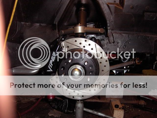

Here is a photo of the Viper caliper on a C body rotor
Fits inside a 15" wheel

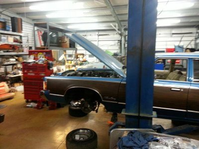

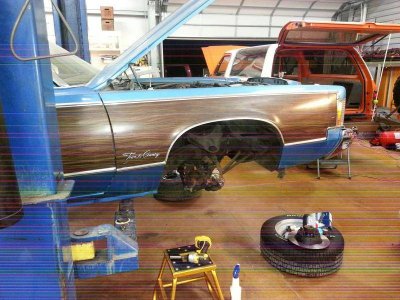

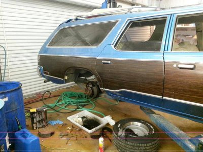

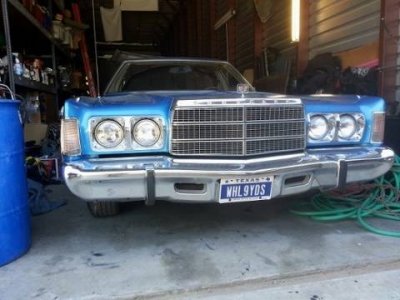

Got the brakes rebuilt this week. I will be working on a different system for the stub when I install it but I want to drive it in the mean time to start working some of the bugs out and have my paint and body man look it over.20150321_203246_resized.jpg20150321_203351_resized.jpg20150321_203422_resized.jpg20150321_203339_resized.jpg
I was able to locate a source for the original style 3M DI-NOC vinyl wood grain trim. There seems to be considerable more choices than were originally available. I intend to do a complete repaint and will probably use a lighter wood grain color than was available originally. I will keep the paint in the blue family but have not made a decision on exactly which shade to go with. I always liked the metallic Cadillac Firemist colors. I am going to have the interior redone in Leather and Cloth in the style of the 1960's Chrysler, Lincoln and Cadillac's. I hope to find an OEM brocade type cloth but I have to get the paint locked down first.
