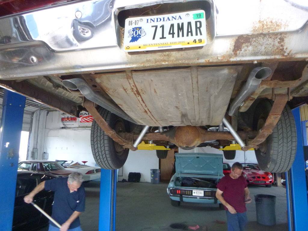

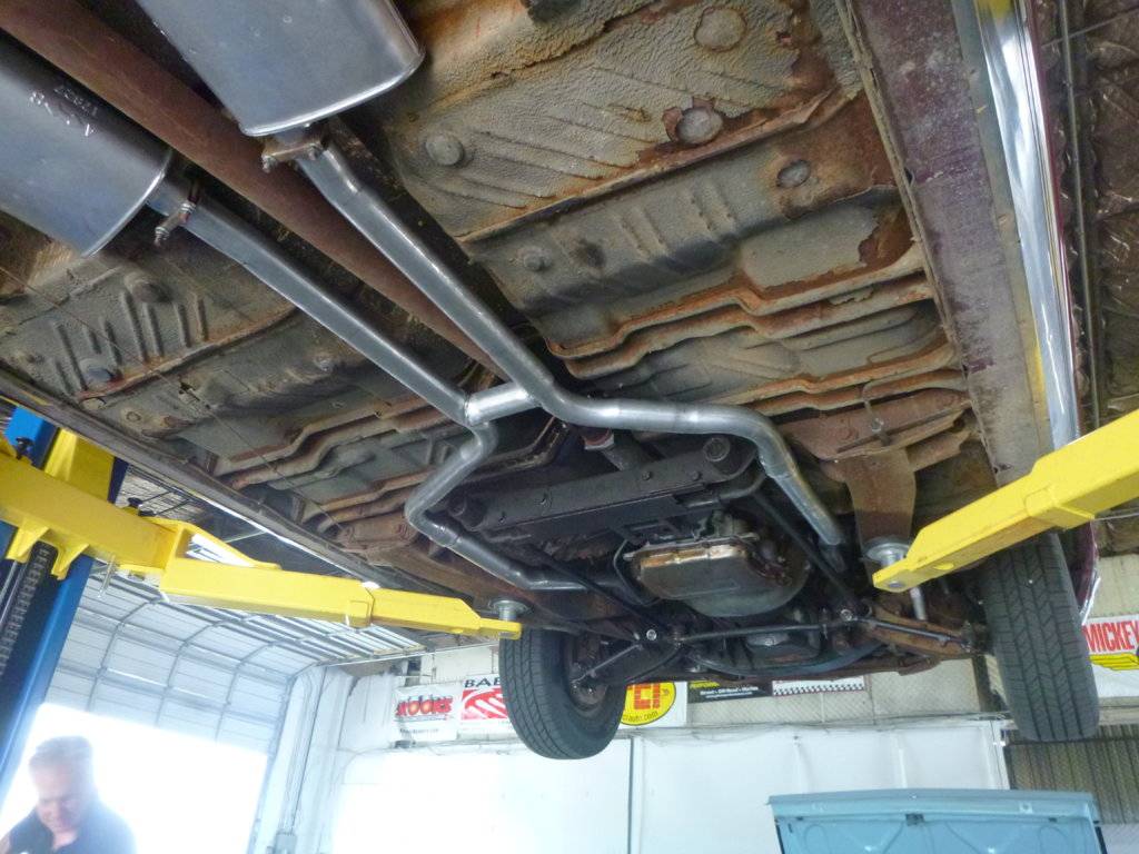

finally got my new exhaust installed

nice and rumbly on the outside and whisper quiet in the cabin
went with Walker 17827 SoundFX
idk why it took my 3 years to get a new exhaust put in huge improvement from the failing glasspacks

LOVE those OEM contours at the end of the pipes!! Plus the H-pipe, too. Thanks for the pictures! Might want to get a small drill and put a drain hole near the end of the pipes, prior to the OEM kick-up. Same near the rear of the muffler body. OEMs had them for condensate drains. About the size of a ballpoint pen tip, or a bit smaller.

that thought has grazed my mind, for a few seconds and i forget about it >_<
what do you mean by OEM kick-up?
The “kick-up” then down with the baloney-sliced exit. Exactly replicates original tips. Few exhaust installers get it right.
