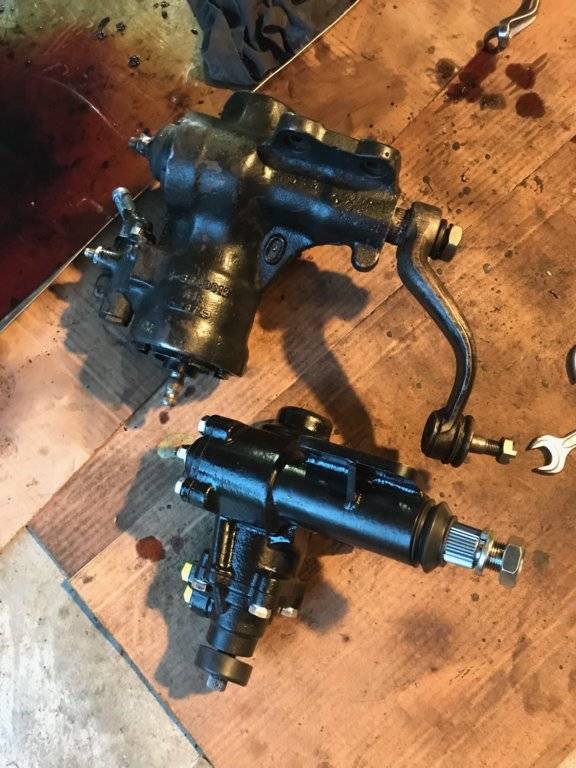

That is a comparison picture of Borgeson and oem Part. The Borgeson Box is smaller and light whigt compared to the OE Box. It has a quicker Ratio (approximativ. half a Turn less lock to lock). It has no noticable lash and requires slightly higher Steering effort. This swap is still not like a new vehicle with rack and pinion steering. You would Need to modify complete frontend.
You would also Need to have a good ps pump. I followed the borgeson recommendation and bought a new pump and hose set all at once. I like the new steering feel. I feel much safer than before with a cardone rebuild box which was horrible.
