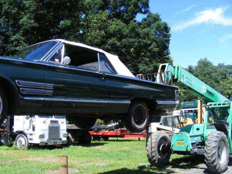

this is what i am starting with .this pic is the first stage of the start of my resto.project .since this car came from far north i am treating the whole under side with chlorid to completly desalt the metal . this looks like quite a project its about what i expected but a lot less than i hoped for
chlorid is used on bridges and other steel in high salt areas fairly simple process however the product is quite expensive. its sprayed on let dry then high pressure washed usually two apps. this process is a must before sand blasting `blasting will drive dry salt into the metal surface cc
